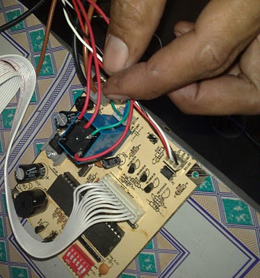

2. A "Digital Timer circuit with 3 digits 7segment display and a relay switch" that will be used as the source power of the Logical Circuit Switch.

This is the model of a coin selector that i will use
and the attached image is the digital timer.

As to the timer, what does it output? Meaning for example a logic high or low for a preset period?
Ron
The output of the timer is depend on what you will connect to the output relays.
