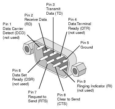

You did mention you had some programing experience so here is what I suggest so you can experiment a little. If you have a system sitting there with a RS 232 port you can use that for some basic functions. Other than the actual data transmit and receive lines (pins 2 & 3) the RS232 serial interface has a few pins that can be quite easily used as DIO (Digital In Out). For example the CTS pin 8, DSR pin 6 and the DCD pin 1 all can be very easily used as digital imputs sending a true (logic high) or False (logic low) to any software you write.
While I am not very good with this stuff I can read those pins using VB (Visual Basic) and have the OS respond to changes like shutdown, logoff or restart. Those pins are low by default and a logic high is as simple as 5 to 9 volts being applied to any of those pins and ground (pin 5). If you want to take that route maybe I can give you a few code sample programs to work with. They would be in VB 6.0.

You mean i can connect direct my coin selector gadget direct to a RS232 port?
Actually, i never tried programming like this before, i always depend on the drivers. but if you give some codes as to my guides. i will try to understand to make it work. Visual Basic 6.0 is great than any other tools.
Attached image is a RS232 pin out.
Please see me your VB6 codes to this email moonstar_catcher@yahoo.com.ph
I hope i can work with it... Thanks!

In your statement here, it sounds that i can connect directly the coin pulse signal from the Coin Selector to RS232 pin 1, is that correct?
if a RS232 port from the MOBO can detect 5-9vdc as a signal, i can still use the digital timer as an output signal which is 0-5vdc from its microprocessor.
Please correct me if i am wrong. :)

RS232 Voltage Levels:
The RS-232 standard defines the voltage levels that correspond to logical one and logical zero levels for the data transmission and the control signal lines. Valid signals are plus or minus 3 to 15 volts; the ±3 V range near zero volts is not a valid RS-232 level. The standard specifies a maximum open-circuit voltage of 25 volts: signal levels of ±5 V, ±10 V, ±12 V, and ±15 V are all commonly seen depending on the power supplies available within a device. RS-232 drivers and receivers must be able to withstand indefinite short circuit to ground or to any voltage level up to ±25 volts. The slew rate, or how fast the signal changes between levels, is also controlled.
For data transmission lines (TxD, RxD and their secondary channel equivalents) logic one is defined as a negative voltage, the signal condition is called marking, and has the functional significance. Logic zero is positive and the signal condition is termed spacing. Control signals are logically inverted with respect to what one sees on the data transmission lines. When one of these signals is active, the voltage on the line will be between +3 to +15 volts. The inactive state for these signals is the opposite voltage condition, between −3 and −15 volts. Examples of control lines include request to send (RTS), clear to send (CTS), data terminal ready (DTR), and data set ready (DSR).
Because the voltage levels are higher than logic levels typically used by integrated circuits, special intervening driver circuits are required to translate logic levels. These also protect the device's internal circuitry from short circuits or transients that may appear on the RS-232 interface, and provide sufficient current to comply with the slew rate requirements for data transmission.
Because both ends of the RS-232 circuit depend on the ground pin being zero volts, problems will occur when connecting machinery and computers where the voltage between the ground pin on one end, and the ground pin on the other is not zero. This may also cause a hazardous ground loop. Use of a common ground limits RS-232 to applications with relatively short cables. If the two devices are far enough apart or on separate power systems, the local ground connections at either end of the cable will have differing voltages; this difference will reduce the noise margin of the signals. Balanced, differential, serial connections such as USB, RS-422 and RS-485 can tolerate larger ground voltage differences because of the differential signaling.[6]
Unused interface signals terminated to ground will have an undefined logic state. Where it is necessary to permanently set a control signal to a defined state, it must be connected to a voltage source that asserts the logic 1 or logic 0 level. Some devices provide test voltages on their interface connectors for this purpose.
Yes, I have used both 5 volts from a small 5 volt PSU and also used a 9 volt battery to provide a logic high to the pins I mentioned. I don't know exactly what your coin system is giving you. The idea was to show that there are lines on the RS232 that can serve as simple DIO lines. The input logic lines are either true or false (True = High and False = Low) they are false by default.
