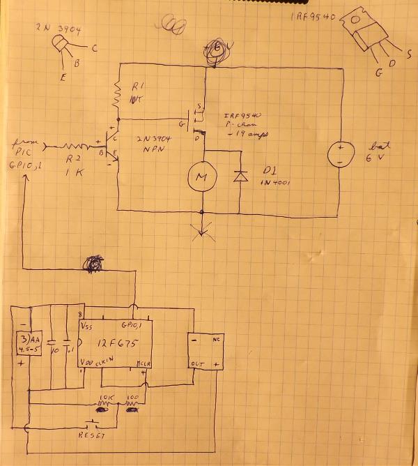

Can you post a complete schematic that's bigger than a postage stamp - including ALL components. What you posted above is unreadable.
Mike
I don't use any of the schematic programs. Usually just hand draw something but in this case it was so simple that I just built it on a breadboard and tested before transferring to a solder board. The output amp circuit I got online and drew on the graph paper that was in the photo above (post #9). Sorry it didn't come out more readable.

What you don't seem to understand is that what you assume to be valid may be totally wrong. Post a schematic, hand drawn or otherwise and we may be able to help. There are many questions asked above that you have still not answered - answering them may get you help.

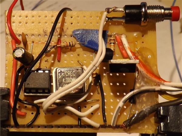

Here's a hand drawn complete schematic and a picture of the board before the separate power was added to the MCU side.
On the schematic there is a common ground for all.

Your grounds have to be tied together, else the GPIO output has no reference to the NPN ground.
And a reminder about my final point, the P channel MOSFET may not be turning on fully with lower gate voltages. While it may start to conduct at -4V Vgs, your 6V supply may not be enough to turn it on fully. AT colder temperatures, this may be a small factor, though I tend to agree it is more likely something around the PIC circuit itself...
