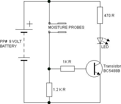

Here is the schematic I am making for a water activated switch - for a watrer level....
Any suggestions as to how to make it SUPER sensitive >>> I will have one probe contact at the bottom of an acrylic tube - the other ( a needle) set in a rubber fixture....... when the water touches the point of the needle I want the led to light up at the SLIGHTEST contact............
ANY HELP HERE ????

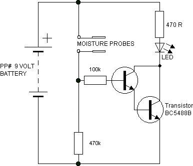

Two ways to increase sensitivity
1) Increase the value of R2. 1.2K is very low.
2) Use darlington configuration making use of two BC548's. The base of first transistor is connected to the biasing network while its emitter is connected to base of other transistor. Collectors of both transistors are tied together and used as if it is a colletor of single transistor.

Yes, darlington is a standard transistor confuguration wherein you can get very high current gain. The output curent of this configuration is Hfe^2 (square). Thus even for very low input current, you get high cuurent output to drive the LEDs.
Instead of 1.2k use 47k or even try 120k resistor.

The 2N2222 is an OK replacement. For your purposes, basically any NPN small signal transistor is OK.
Just one problem: if the water is destillated: no conduct. Drinkwater is conductive, but the positive electrode always go to solution (corroded).
For direct sensing use AC to avoid the corrosion.

"they [the transistor from radio shack] had differant values than the one I noted on the schematic"
The transistor labeled "BC5488B"?
A simple search shows me such a transistor does not exist.
Most likely it is supposed to be the BC548B.
This is a common NPN that is very much the same as the 2N2222A.
What are the different values that you noted?
I noted I had one of the 2N2222A transistors from Radio Shack on hand.
Since this is such a simple circuit I quickly tested it.
I also replaced the 1.2K [one thousand two hundred] ohm resistor
with a 47K [forty seven thousand] ohm resistor as many others here have reccomended to you.
Using common tap water [mine has 1 million 400 thousand ohms resistance per inch]
the slightest touch of the probes to water caused the LED to light to it's full brightness.

You can use any NPN transistor in darlington-pair.
