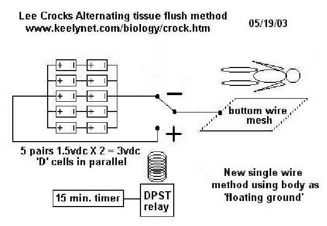

I don't know much about electronics, but am trying to construct a simple unit to experiment with health/therapeutics.
Web reference is: **broken link removed**
Attempted to attach the diagram as well.
Known as Lee Crock healing device (5/19/03 design diagram), it is basically 5 pair of 1.5 V "D" batteries that create 3V DC current. A single polarity is exposed to target region without closing the circuit. Ie., biological target serves as opposite polarity and ground.
This switches every 15 minutes. Timer should run off AC converter unit (not use the batteries).
My challenge is to find a circuit board or device that can serve as the timer and relay. Something a layperson like myself can easily acquire and incorporate into the build.
Any help greatly appreciated,

You could do it easily with a 555 timer in astable mode, and a changeover relay - but electronically the diagram looks totally rubbish!.
For a start why parallel 5 pairs of batteries, when you aren't taking any current off any of them? - assuming it's 'supposed to' set up a 3V electric field - a single pair of tiny batteries would function identically.
The original diagram on the website, with two contacts - one either side of the body - was bad enough, but then to use just one :lol:
I can only imagine that the device attempts to work by the 'placebo effect', and it's main purpose is to make the author rich! - only $250!, what a bargain :lol:

Hi Vandy33,
Indeed a 555 timer can be used. There are a lot of applications build with a 555 timer.
In your case you must use an astable. The 555 can directly drive a small relays. If the on/off cycle must be 50%/50% then you must add a diode,
to have sepate current path for charge and decharge. Should you need
more info please ask.
look here how to get a symmetric cycle:
http://www.williamson-labs.com/555-circuits.htm
look here how to connect a relay to the output signal on pin 3
http://www.qsl.net/yo5ofh/hobby circuits/circuits_controlling_relays.htm
Also with 2 transistors , an astable can be build.
Since 5 pairs are used I suppose that a fst charge is imprtant.
then you must select a relays with low " debounche" characteristics.

Except there's no current flowing anywhere, and nothing to charge?.
It looks to me like a pure scam, but if it works for someone - fair enough, at least he publishes the details so you can make your own. Certainly what he wants to charge for making one is outrageous.
If there is a device electrostatic charged and isolated from the ground and you touch it , you wil feel current, although there is only one wire (your body to the ground).
Same example with lightning, there is only one current path.
So I don't think you need in any circumstances 2 wires to have current.

You need a continuous path for current to flow - in your example you even quoted it - 'through your body to the ground', and from the ground to the other side of the source. Bearing in mind you are talking about serious voltages here - hardly comparable to 3V from batteries!. In dry air 10,000V is required to jump 1cm, in damp air it's greatly less than this, and lightning can run into the millions of volts.
