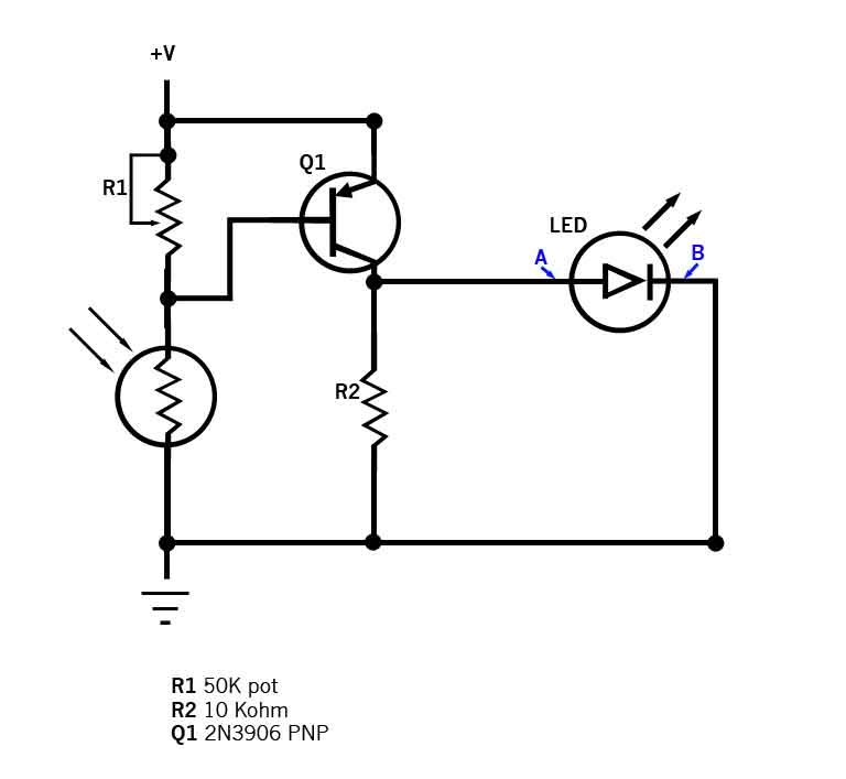

Can someone show me an effective circuit that will turn on at night and off during the day.
I have been playing around with one circuit I found but the problem was that the LEDs always drew some power from the batteries even when in full light (they should've been off). Then when it was dark they were never bright enough. So in order to increase the intensity of the LED I increased the source Voltage but this also increased the voltage drain when it was off (in full light) .

Please post the schematic an explain properly what you want to do, what application does your circuit have?

Problems with my circuit.
My batteries are putting out 7.24VDC
The Potentiometer is dialed to a point where I get good illumination when on (in Dark) and apears off when light hits the Photoresistor.
Question 1.
When I try to read the resitance of the pot I get 1.14 when the multimeter is set to 20K, how should this be read is it 1.14 Kohms?
Question 2.
I am taking my multimeter readings from A and B (from the pos & neg of the LED). Is this the correct place to take the reading from ?
Question 3.
The LED Load when on is 5.85V This seems a bit much for a LED that is supose to light at only 3V.
Do you agree ? if so how can I reduce my voltage to the LED and still get the illumination I want ?
Question 4.
LED Load when off is 1.3V
This is the problem because I would expect no voltage to be read when the LED is not lit, can you sugget why it is drawing so much voltage when it apears off and how I can solve this ?
Question 1.
Are you reading the resistance in circuit, or out?
mettam said:
Question 2.
I assume you mean the voltage reading?
mettam said:
Question 3.
Put a resistor in series with the LED. Use Ohm's law based on the current spec of the LED.
mettam said:
Question 4.
It seems the bjt is slightly on. I'm not sure I understand why the LED is in parallel with the collector resistor. Why not eliminate the collector resistor and put a series resistor in line with the LED based on Q3 above?
I am reading the resistance directley from the Pots leads while it is pluged into the bread board, the battery is turned off.
Yes I mean Voltage reading.
What is the bjt ?
Reading the pot while in-circuit is not just the pot resistance, it is with the surrounding circuit, and could be way off - even different when power is applied. The bjt is short for bipolar junction transistor. Try eliminating the collector resistor and put a small series resistor with the LED.
