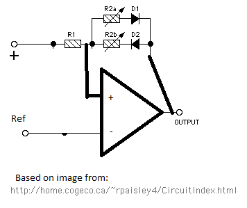

I'm looking for (been looking for) a non-inverting comparator circuit where the adjustments of the hysteresis are independent. I know what the typical (LM393) non-inverting comparator with hysteresis looks like and how it works.
Vth1 = Vref + (Vcc - Vref) *R1 / (R1+ R2 + RL)
Vth2 = Vref - (Vref - VoLow) * R1 / (R1 +R2)
Adjusting either R1 or R2 adjusts both Vth1 and Vth2. I'm looking for a similar circuit where Rx effects only VthLow and Ry effects only VthHi. Any one here know of something that fits the bill?
You can connect a diode in series with Rx and Ry to cause each resistor to affect only the high or low reference voltage.
dougy83,
The resistors Rx and Ry I mentioned are to fictitious components in the unknown circuit. If your references of Rx and Ry are to R1 and R2 of the original circuit, I was not able to get the desired (or expected) result. I added the diodes in series with R1 and R2. The best arrangement I could find (both forward biased from Vref to Vout), R1 and R2 affected VthLo and neither R1 or R2 affected VthHi (VthHi was only effected by Vref, which also affected VthLo).
Here's what I meant. Hope it makes sense. (I also hope that it works)

Vcc becomes (Vcc - 0.7)
Volow becomes (Volow + 0.7)
I used 1N914 diodes in the circuit above. I have a few differences. Vref is connected to R1 per the LM393 datasheet and Vin is connected to comparator '-'. I also added a fixed resistor in series with R2b and D2 to help keep the VthHi higher than VthLo.
I have attached the input signal to a 10k pot if I move the pot slowly through the range from VthLo and VthHi the output appears to come "halfway" on. I don't have access to a scope, only a DVM. I don't think it can be "halfway" one, so the output must be chattering? The actual output is a relay and an LED so the "half" output is visually (LED is half brightness) and audibly noticeable (relay is chattering). I'm thinking the output must be bouncing on and off as each of the diodes becoming forward biased then reversed biased and forward biased again. What are your thoughts?

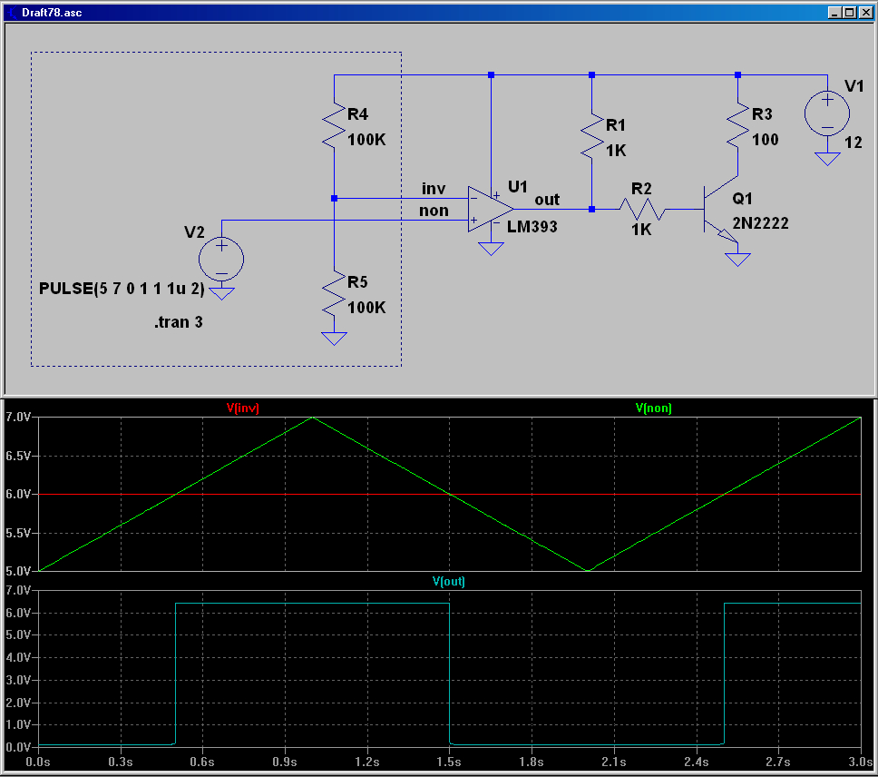

Stare at this for a while, and tell me why V(out) only pulls up to ~6.3V
Also, With a 1K pull-up, how much current are asking the LM393 to sink?
Vout only goes to 6.3V due to the 1k-1k-diode resistor divider. And the output is sinking 12mA, about 60% of its 20mA capacity. Where are you headed, Mike?
He's probably getting at the point that the voltage on the output of the comparator affects the switching points. You could increase the base resistor, or just adjust the setpoints based on the reduced output voltage, if you haven't done so already (I assume you may have as you said that it's working).

You seemed surprised that the voltage at the output pin was about half supply. The data sheet Im looking at suggests that to get a Vol < 0.25V, the output sink current must be < 4mA. At 10mA, the Vol is > 1.5V
If the output is chattering, then you need to add hysteresis to the comparator's feedback.

I'm not surprised that I get 1/2Vcc for VoutHi. I'm surprised that I can get 0.4V, 4.2V and 6.3V from the output. The input has hysteresis per dougy83 circuit as listed above.
Dougy: How much base drive do you think is needed if I need 240mA on the collector of the added 2N2222a?
According to https://www.electro-tech-online.com/custompdfs/2013/08/2n2222.pdf the DC current gain for Ic 150mA out is between 100-300. If it's 100, that would mean you'd need 2.4mA base current for your 240mA load. You can decrease this by adding a transistor (darlington configuration), using a FET or even isolating the base current from the comparator output by using a couple of diodes and a pullup resistor. Or, you can just factor in the actual output voltage when setting up your threshold voltages.
