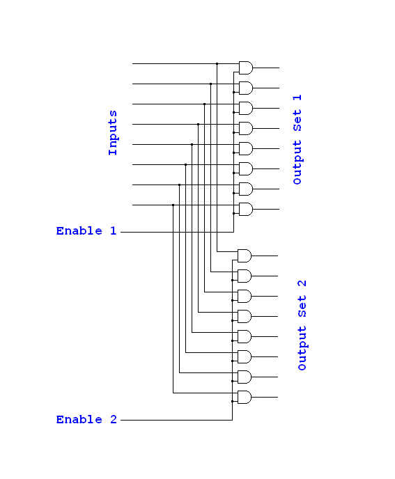

I looking for device that help me split a n bit input bus, or n analog lines into two or more bus at output
Please consideration concept diagram below.
At input there is n bit input bus, or n analog lines
At control there is 2 bit control:
00: input signal not routed to output
01: input signal routed only to output 1
10: input signal routed only to output 2
11: input signal routed to both output
I cannot think of any ready made digital logic device I buy at counted do this, hence need some help to realize this using ready made digital logic device.

If you want to, you can even store the data from the input until you want to read it later. You would use two 8 bit latchs with tri state outputs. You would connect the 8 inputs together and use the enable pins as your select bits. Bit 0 would enable latch 1, and bit 1 would enable latch 2, so that with both bits both outputs would be enabled. This of course is not a single device but two packages, but the circuit board routing is probably easier as you can spread the packages out a little more than with a single chip. The only extra routing complexity is that you have to wire the input lines together so that input bit 0 connects to input bit 0 on both packages, and same with bits 1 through 7.
Take a look at devices 74LS373 and 74LS374 or similar. These are available in small outline package or standard DIP package.
I believe 2 AND gates would do it.

An AND gate can act as a digital switch. If one input is 0, the output will always be zero (gate turned off). If that input is 1, whatever is on the other input is passed through to the output.
So it is as simple as one input can act as a "gate control" that turns the gate o/off, then the other input is the "signal".

Hi again,
Here is a drawing to illustrate MrRB's idea. You just have to make sure that whatever you use to drive the Enable lines with can handle the required number of gate loads (as drawn, 8 loads for 8 bits) unless you use a separate buffer.
