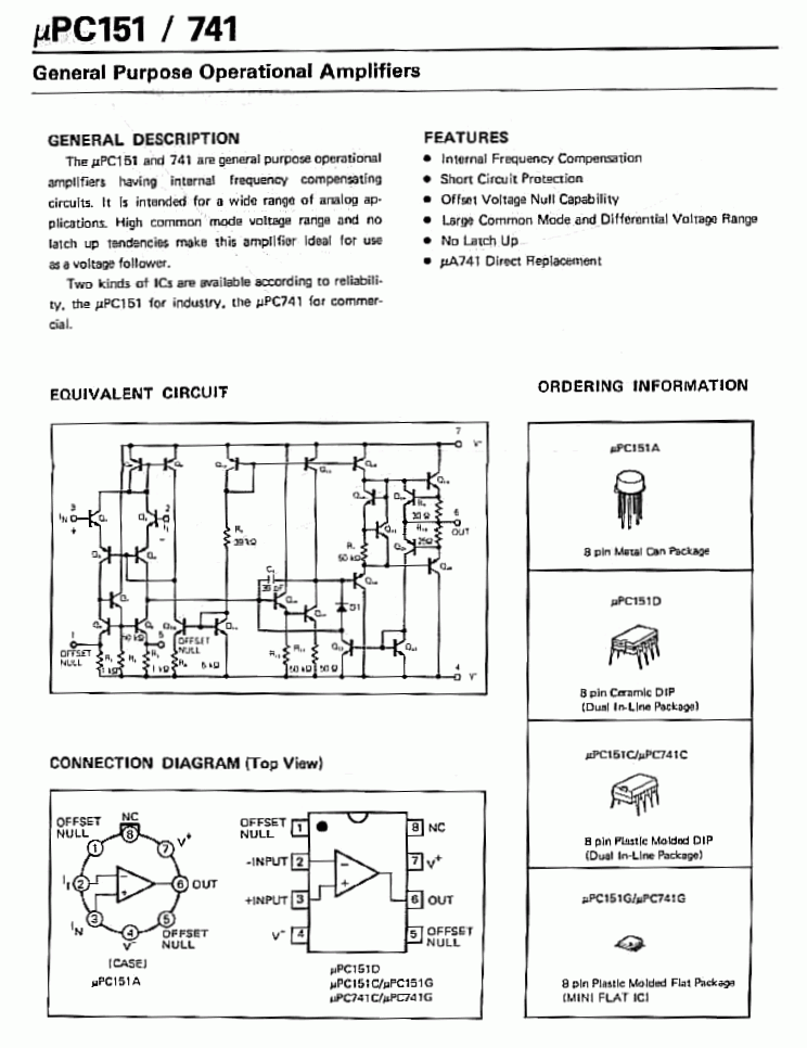

Hello,
I have got one 8-pin IC of NEC make with part no. C151C. I 'm not avble to find this IC in market.
Can someone suggest me its equivalent Device (pin compatible) please?
Thanx
Sujit_51

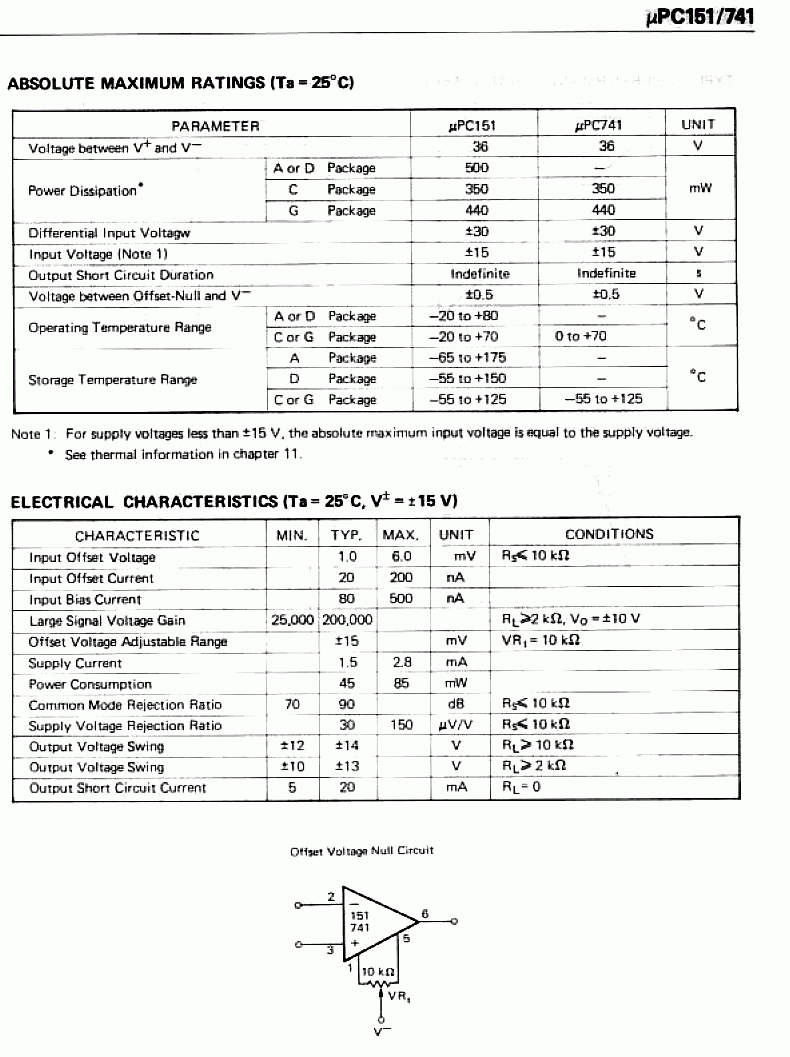

Will this work?
  • upc151c_741.pdf
Here it is in GIF
