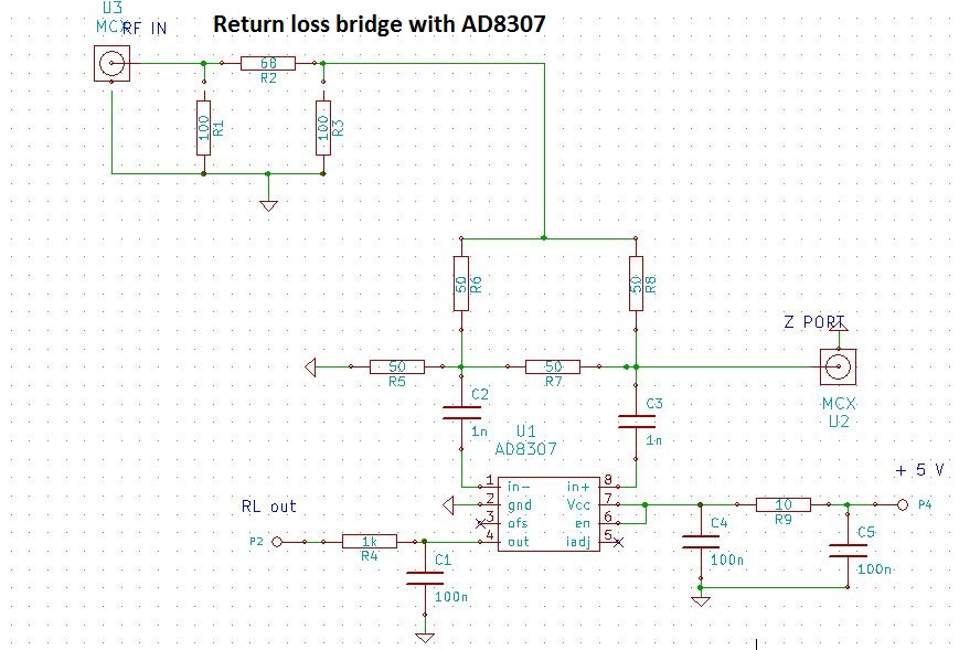

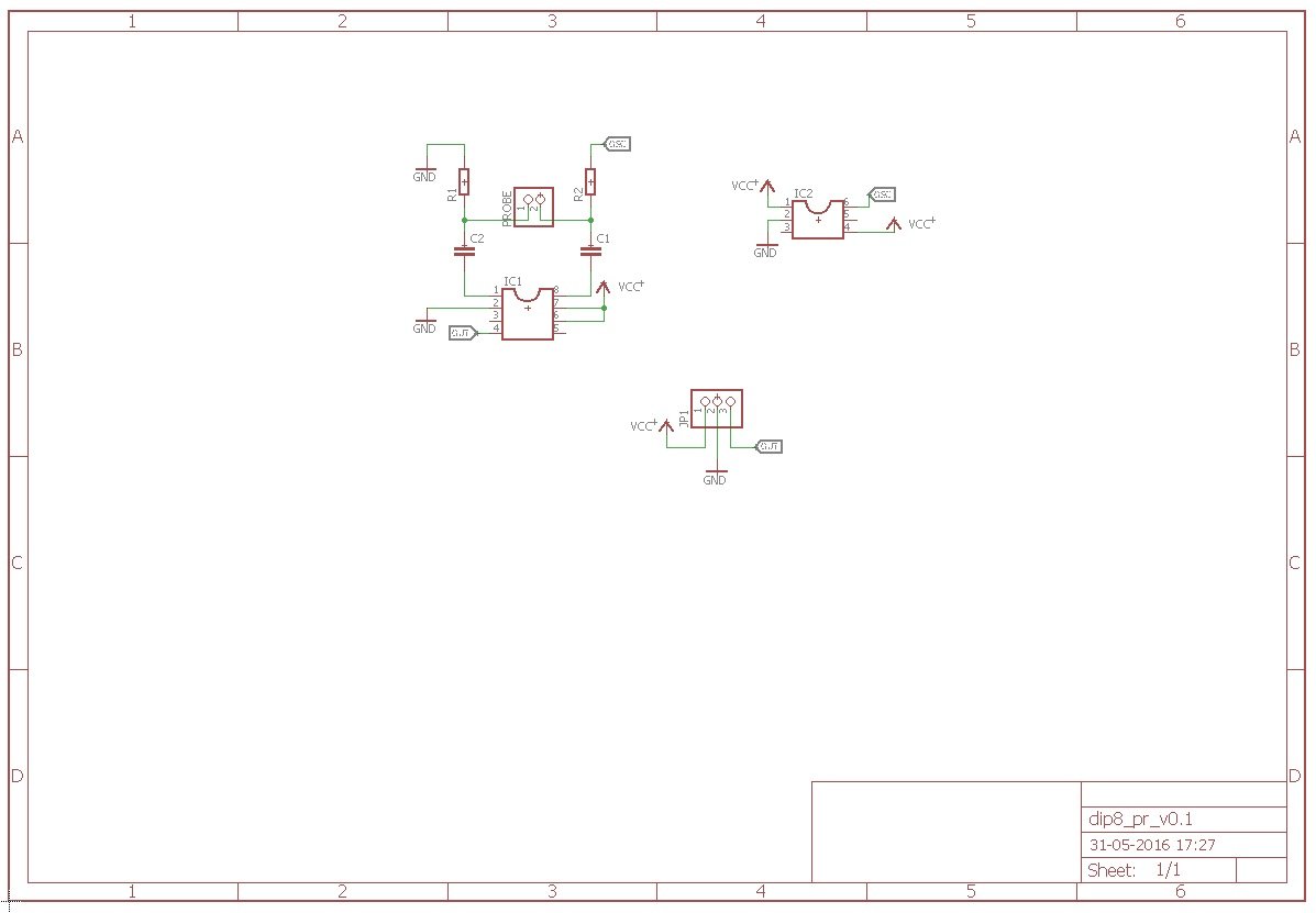

For this project I need to include a loss bridge. The purpose of this bridge is to measure variations in sensor capacitance. The sensor consists of a antenna inserted in soil, emitting a 100MHz signal obtained from a LTC6905 oscillator, and the measurement is done with a AD8307 logarithmic amplifier. The probe uses 2 insulated and waterproof parallel insulated copper strips; hence measurement is not done through electrical current but through electromagnetic fields.
I found a design used in a commercial moisture sensor measuring emitted power, and a design used for regular RF antenna or load balancing using a reference load.
For this project I presume both principles may be used, but I would like to receive your critical reviews on pro and con of each design principle.
The first attachment shows the design for the commercial unit where IC1=AD8307, IC2=LTC6905, R1&R2=470R, C1&C2=10nF

The values for the other, second, loss bridge are marked on the drawing.
What would/are be the pro and con for each design?

Second circuit
The second circuit in post#1 of this thread is a true Return Loss Bridge, it uses a Wheatstone type bridge which is made up from 50 ohm resistors R5, R6 and R8, the bridge is completed by the unknown impedance connected to Z-Port.
R7 forms a termination resistor on the input to the detector U1. (I am not sure if this resistor is strictly necessary here in this circuit.)

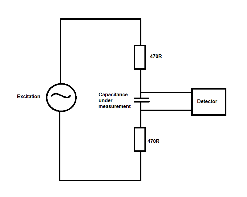

First circuit
If I interpret the first circuit correctly, it is not in the form of a bridge but a series connection of two 470 Ohm resistors in series with the capacitance to be measured (the soil moisture probe), as shown here:
Here, the voltage is being measured across the capacitance of the soil moisture probe.
To me, this feels to be a much more appropriate measurement method than the use of an RLB.

First circuit

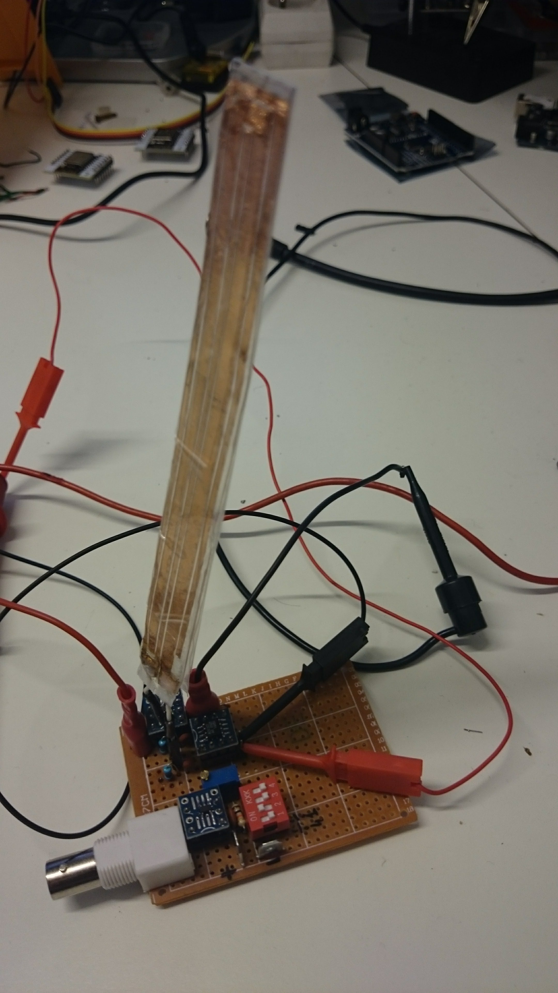

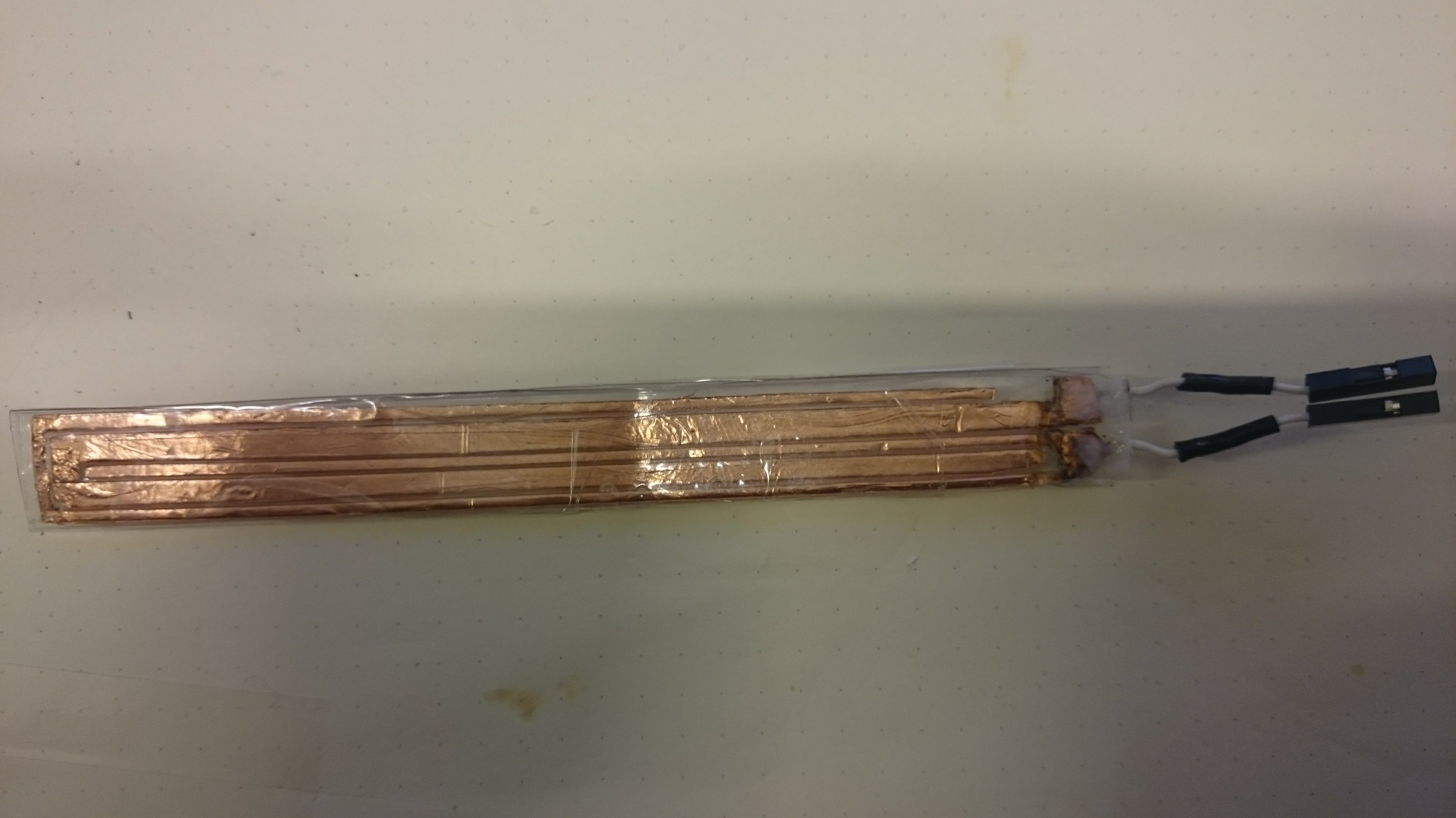

Hi Jim, thanks for replying; we seem to agree :): I used that circuit (#1) for testing today.
Results are measured at the AD8307 output. I use selfadhesive coppertape on a thin transparent acrilyc substrate, taped all around to make it impervious to water and moisture.
1. With 2 simple strips of copper 3mm wide, 10cm long and 1mm separation I measure 2.30V in open air, 2.12V submerged
2. With more complex pattern of 2 strips 2mm wide and 20cm long, 1mm apart, both in a interwoven U-form, I measure 1.95V in open air and 1.70Vsubmerged.
The results are fairly repeatable but I have to do much more testing before conclusions can be made.
But it seems as if it will be hard to obtain more than 500mV between dry and wet, so some sort of amplification will be needed.
In circuit #1 the sensor will have to be made as discriminatory as possible between wet and dry; when the sensor is left in the air it represents a higher load than when surrounded by water because the AD8307 output is higher; so there will have to be a way to make the difference when surrounded by moisture (and hence lower loss or higher transmission between the two poles) as high as possible while when dry the sensor has to represent as high an impedance as possible.

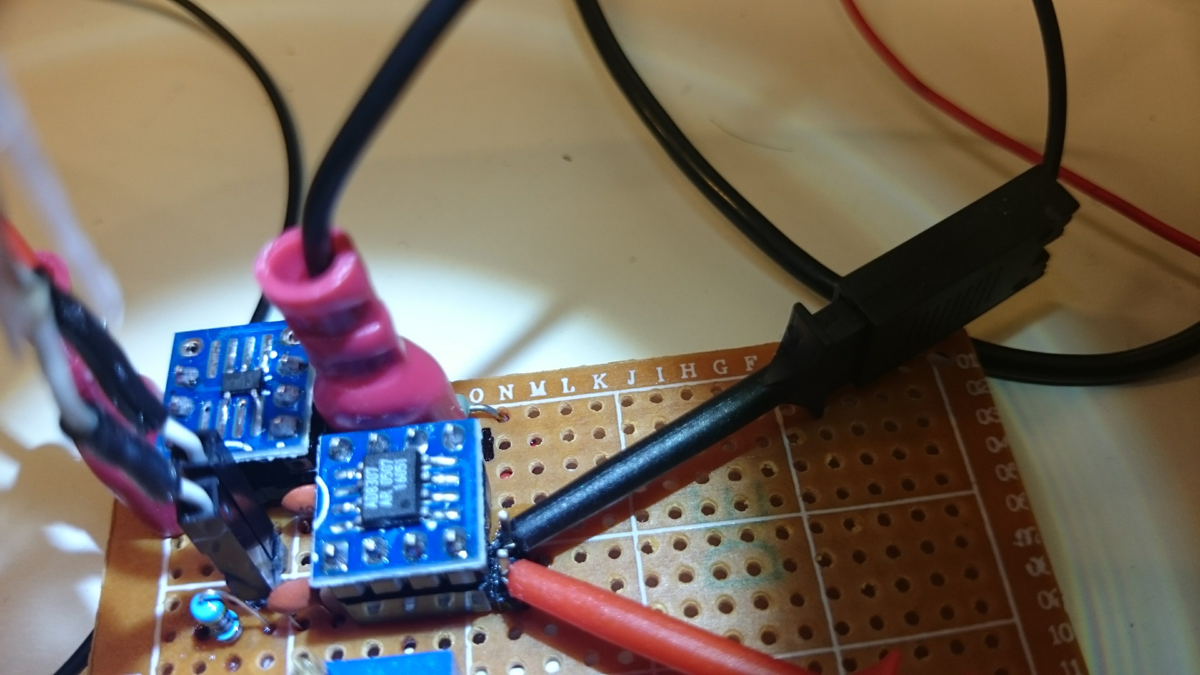

Here are some pictures of the second sensor test and the test setup. The sensor connectors are the black Dupont plugs, the AD8307 probes are the red and black ones at the right.
Meanwhile I was able to increase the spread from 2.35V to 1.90V due to some tweaking at the sensor base.

Without testing myself I cant advise you on the best detector, however one thing I notice on your prototype, the osc in my opinion ought to be in a screening can to avoid bleed over.
Also the wires to the probe would need to form a transmission line, unless you put all the Vhf stuff on the end of the probe which is probably the best way.
Your results sound Ok.
