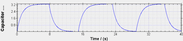

You will understand all of that much better when you take a calculus course. The 'e' is Euler's number, and is approximately 2.71828. It is useful when the slope of a function changes over time proportionally to the value at any given time. Basically, the more stuff there is, the faster the stuff is going to change. :) Large voltage across the cap makes the voltage vs time curve slope sharper. As it discharges, the voltage decreases. So does its rate of discharge, accordingly. Similar deal with charging. Below is a picture of an RC circuit repeatedly charging and discharging. Ignore the scale, I just grabbed it from a google image search.

Bonoxer's chart shows how the slope of the waveform is much steeper at the start than later in the curve. This illustrates why mstechca's method is not accurate. mstechca assumed that the curve is a straight line.
Len
