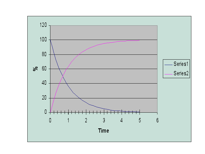

Looking at my graph of the percentage of charge vs RC time is simple and accurate too.
Experimenting with an oscillator having a repetitive RC charge will let you see my graph right on the screen of a oscilloscope. A simulation program would do the same thing.
Here are graphs for charge (red curve) and discharge (blue curve)
The time axis is equal to RC.
Example 1
If R = 1k, C = 1 uF Time constant = RC = 1 millisecond.
Time to charge to 40% is about 0.58 ms
Example 2
Time to charge to 80% is about 1.6 ms
Example 3
If R = 10k, C = 1 uF Time constant = RC = 10 millisecond.
Time to charge to 80% is about 16 ms
Len

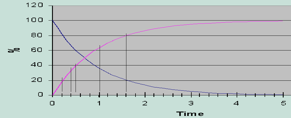

Thanks, Len.
I stretched-out your curves to make it easier to see and marked them.
He, he. The curves in my book are more accurate than yours. :lol:

The formula I posted previously
t = RC ln {(Vdc/(Vdc - V)} is more general. You don't need to be a mathematician to use it.
ln = log natural and is on scientific calculators. It can also be found in the functions (maths & Trig) of the Excel Spreadsheet.
I used Excel to produce the graphs.
The discharge curve is t = RC ln {Vdc/V) where Vdc is the initial voltage and V is the voltage atany time t.
