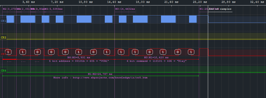

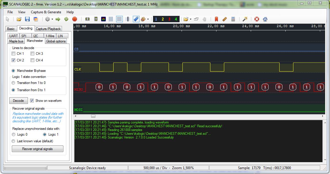

SCANALOGIC-2 just got new Manchester protocol decoding feature! (It's mainly used in wireless transmissions like IR remote controls). This decoder will be the core for a series of other updates to add the support for some IR remote control protocols like Philips RC-5 and Philips RC-6.
If you think of a protocol you would like to see in SCANALOGIC-2, please let us know, we will be happy to work on it!
