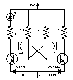

I'd like to make a low current flashing LED circuit. Ideally 5-6mA. One red LED.
Here is a schematic I found for two LEDs:
Any idea how to get it to work with only one LED?
I'm assuming I would have to remove the entire left or right side of the circuit? Will it still flash?

No, just remove one LED and replace it by a piece of wire - even better, increase the value of the series resistor to compensate for the LED no longer being there.
The circuit is a simple slow speed monostable multivibrator, a VERY standard old circuit.
I agree with Nigel, I calculate the collector current to be about 15Ma so replace the 470 ohm resistor and the straight wire with a 620 resistor. In other words put a 620 ohm resistor from the collector of one transistor to the 9V battery connection point.

i think u meant astable multivibrator

Would I replace both 470s with 620s or just the one on the side I'm pulling the LED from?
Also, I don't have two 10uF caps in my parts bin, I do have a 22uF, a 10uF and a 4.7uF...would it work with a 10 and a 4.7?

As suggested, it's a very non-critical circuit, changing the capacitors will affect the flash speed, one capacitor setting the ON time, the other the OFF time. The smaller the caps, the faster the flashing.
Just a few comments:
1. The minimum beta of 2N3904 is 100. This circuit requires a beta of at least 180 to keep the transistors in saturation. I would change the base resistors to 47k. If the same timing is required, raise the caps to 20uF.
Of course, it might work fine as a one-off with the values in the schematic.
2. The collector resistor on the side without the LED can be as large as 10k, saving power and making the battery last almost twice as long.
3. Base-emitter breakdown is probable with a 9V supply. I would switch to 6V (with appropriate resistor and capacitor changes), or put a 1N4148 diode in series with each emitter.

I just noticed Mr. Cool wants 5-6ma. In that case (using the emitter diodes as I suggested), the LED-side collector resistor can be 1.2k, and the base resistors and capacitors can retain their original values.

This is the schematic following Rons comments

This is a astable circuit, which means it has two semi-stable states, with either one or the other transistor been turned ON, and the other being turned OFF. When the LED is lit, then the current is basically that off the current through the LED (set by it's series resistor), when it's OFF, then the other transistor is turned ON, and the current is set by it's collector resistor. So to reduce the current you can increase the value of that collector resistor - but it will have some effect on the timing, and if increased too far will stop working all together.
You can alter the ON/OFF ration by changing the capacitor values, or the base resistor values - probably simplest for you to alter the capacitor, unequal values will give an unequal flashing ratio.
Try different values and see what happens! - it's a good learning experience!.
