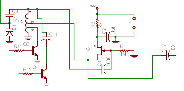

This is one of my favorites. You will need say a 1 inch ferrite toroid for the coil at the frequency you wish to use. I cut this out of a PLL circuit I recently made. So you won't need Q3 & Q4.

Good luck at getting an LC oscillator to run at very low frequencies.

Like I said, you need a 1 inch ferrite toroid. I built one that has a beautiful sinusoidal wave shape. It used electrolytic capacitors in the tank and feedback path.
For a VCO at those freqs it would be necessary to place more than one varactor in parallel.

You are such a pie-in-the-sky BS'er.:D Put your money where your mouth is! It's easy to say, "Oh, just use a ferrite toroid and some electorlytic caps and a bunch of varactors, and it will work". If you post a working design of an LC VCO that will cover the audio range, I will publicly state on this forum that "I am not smarter than a 5th grader!":D
Edit: It has to put out a low-distortion sine wave.
