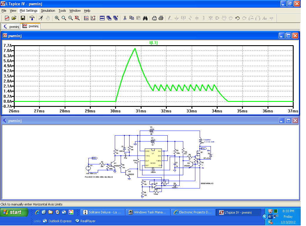

I no longer have the spice file, but I blew it up a bit. See how it looks.

Thanks, Ronv.. From the picture, I could not figure out the mosfet M model used in the circuit. Would you please care to tell me which mosfet model is it?
By the way, I am attaching the first circuit you created. But I am not getting the response you got. I think the MOSFET model is not correct. If you have couple of minute, please review it kindly.
Bugaboo
Bugaboo
I think I figured it out. The capacitance units were off. I thought "mu" is for 10^(-6). Actually, it is "u". Now, I am getting the same results as Ronv. Thanks

After getting to work with simulation of first circuit proposed by #ronv and successfully completing that last night, I am trying to do the simulation for the second circuit. Idea is to simulate both the files and then try to get into details of some of the functionalities of the timer block. That is something I do not understand completely.
Ronv, I know that you do not have the spice files for that. It is bit hard to read of the numbers. I think I have made the circuit schematics in LTSpice and was wondering if you could look at the parameters of different elements. I am attaching the files for second circuit (for which you provided the picture).

Just a couple of changes. I used parts from the spice menu but others might be as good and cheaper. I'm not sure where to find a high power zener so you either need to series up a few lower voltage ones or we can design a transistor one.
