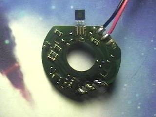

Use a bipolar Hall-switch. It swich on with magnet North-pole and off with South-pole. Canibalize it from a bearing-failed DC brushless motor (PC-supply).

where would this part be located..
i just happen to have one..
would that be it at the top??
i just tested it ..
Yes that is the hall effect switch..
it pays to not throw stuff out.. :lol:

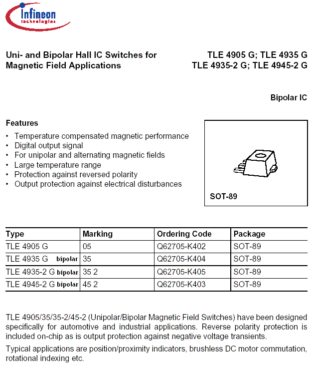

The Infineon hall-switch cost only a half euro, in my country equal to small reed-tube. Also try Allegro Microsystems.
