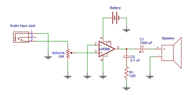

We need to build a mono microphone to 2w speaker circuit with 2v to 5v and less than 200mA power supplies. We had tried the simple LM386 circuit with 5v below but the quality is much less than desired. Can our advanced members please advise some (other) workable approaches? Thank you,
Sorry, but you are asking the impossible.
200mA at 5V is only 1W input power, so a maximum output to a speaker of about half a watt, with a class AB amp.
You also need adequate voltage drive to the speaker to get a particular power level; with 5V a non-bridged amp, you cannot get 1W in to a 4 Ohm speaker.
At 2V & 200mA you are down to fractions of a watt.
5V and a bridged type amp may get you somewhere near, if you have an adequate current available.
A TDA7052 would work down to 4.5V and give around 1W max output.
Or you could try two LM386s in bridge configuration, which is rather less efficient.

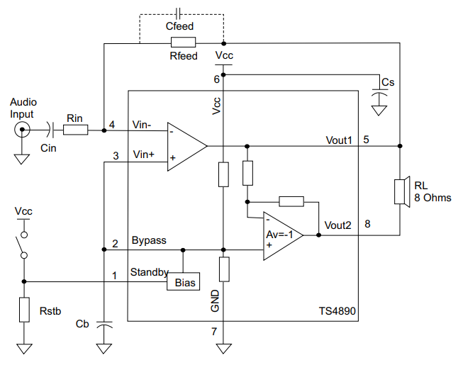

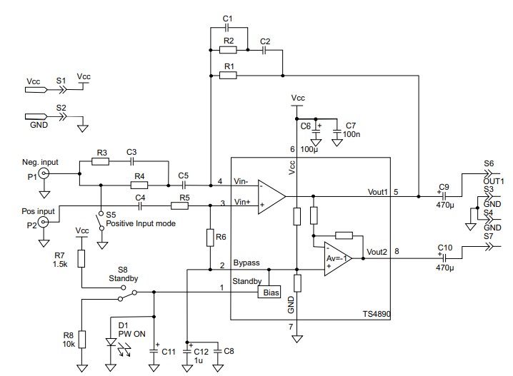

Thank you for your advice. I am new to this. We have to scale the output down to 1W due to the power restriction. Checked with Arrow and someone there recommended TS4890. Do you happen to work with it before? Does it deliver better sound quality than LM386? I plan to follow the sample circuit provided in their datasheet. Recommendations on better configurations will be much appreciated?
Best regards,
The LM386 works fine when it is powered from a new 9V battery and you keep the output into an 8 ohms speaker below 0.45W. Using a higher supply voltage and/or a lower speaker impedance simply makes the LM386 heat more with almost the same output power.
The TS4890 produces only 0.2W into an 8 ohm speaker when its supply is 2.2V. You might need to hold the speaker close to you to hear it.
Why are you using the very complicated Demo circuit (the output capacitors are not needed to feed the speaker)?
Texas Instruments have many modern amplifier ICs.
If the mic can hear the speaker then you will have acoustical howling feedback.

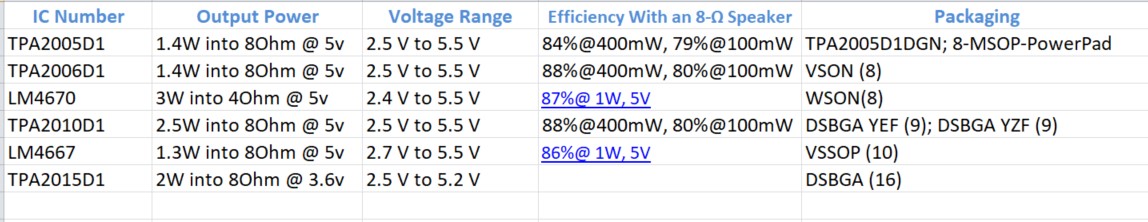

Thank you for bringing up an important factor. Heating is a big concern since I am putting this circuit in a plastic enclosure. Are there any of those TI class-D ICs come with SOP/DIP packaging? If they only come with SMD type packaging, I have a good friend who might be able to help me. I have looked up some ICs as shown below. Can you please advise if any of them is suitable for my application? And if I need an amplifier for the capacitor microphone I will be using?

Can someone please kindly recommend an IC that can do the needed functions?
1. Taking input from a capacitor mic
2. Consuming less than 350 mA @ 5V
3. Output to 8 ohms speaker with about 1W
4. Does not generate too much heat (class-AB excluded?)
Will any of the following works? Do I need an additional mic IC?
All the ones in your list seem to be surface mount types that cannot practically be hand soldered.
The PAM8303 I mentioned earlier should be suitable.
Any of them may need a preamp to give adequate output from a mic capsule.

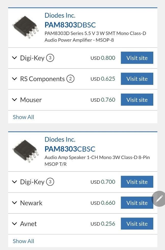

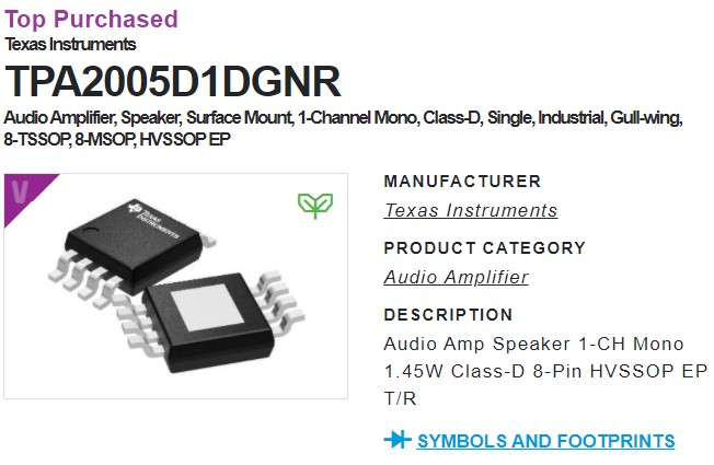

Arrow's website (one of the largest distributors) says PAM8303 is not in stock. MOQ is 2.5k and the lead time is 42 weeks :-(

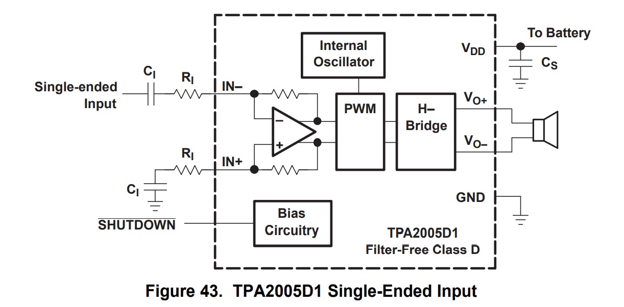

I've found TPA2005D1 is widely available with a workable packaging. Can you please advise a better way to connect the only mic in my application? Assuming it will need something like TS472 to preprocess the mic output before import them to the TPA2005D1?
Can you also please recommend the sizes and the locations of capacitors to reduce the interference?
Thank you,

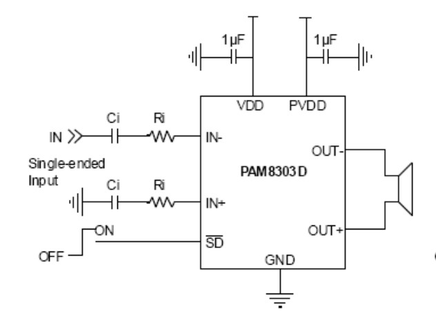

***UPDATE: Found PAM8303D from Mouser. Will try it.
Are additional capacitors needed for the PAM8303D to reduce the interference ?
Thank you
You will have feedback howling interference if the mic can hear the speaker.
You will have low frequency hum interference if the mic is not connected with shielded audio cable.
You will also have hum interference if the 5V has poor filtering.
The datasheet for the PAM8303 shows both VDD and PVDD pins connected together with a 10uF capacitor to ground.
The TS472 preamp circuit shows a complicated balanced input and balanced output that are not needed.
