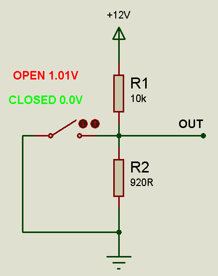

Like This????
Try that one first.
It's much simpler.
