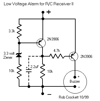

Hi everyone.I have come across this basic low voltage alarm but im not too sure on how it works.
I know that when the first transistor is saturated the second one switches on the buzzer,but how does the current to the base of the first transistor increase as the voltage of the battery drops.I know it has something to do with the zener diode.Could anyone kindly help explain how the first transistor works.Thanks Allot.

The first transistor (the one connected to the zener) is normally turned on, holding the second transistor off. When the voltage drops below about 4 volts, the first transistor turns off allowing the 2nd transistor to turn on and sound the buzzer.

The Biggest problem with that circuit and most others is they draw a lot of current, Pulling down your battery even faster.
There are Special IC's that are designed for low battery detection. They draw Very Low Power and run a Pulsed LED, also at low power.

I don't think it really matters much, the circuit above probably only takes about 1mA or so (when not activated) - that's a pretty small consumption compared to the rest of your RC gear.

I've always thought that was weird that the low battery indicators light up (or buzzes) when the battery gets low. I mean, isn't that when you want to conserve power? I've seen some circuits that an LED flashes intermittantly on a low battery and draws nearly no power.
