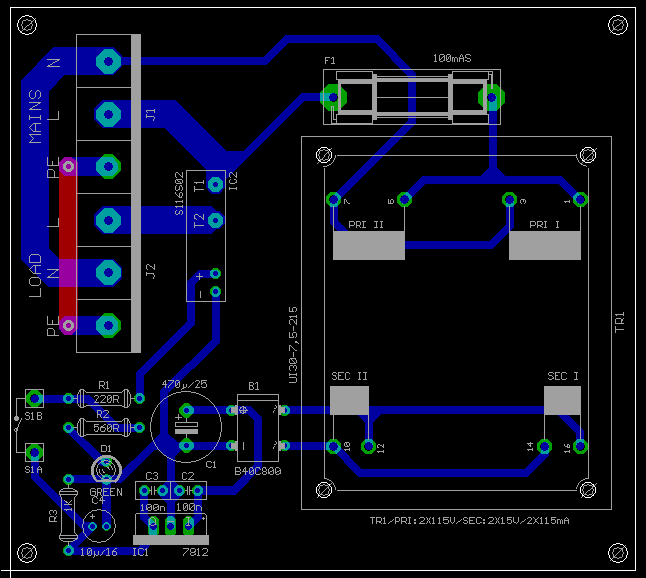

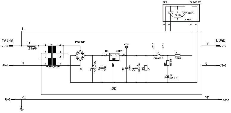

The SSR is designed for a maximum current of 16A at 115VAC. There is plenty of space on the PCB for a heatsink if necessary.
SSR type is Sharp S116S02, fully plastic encapsulated.
