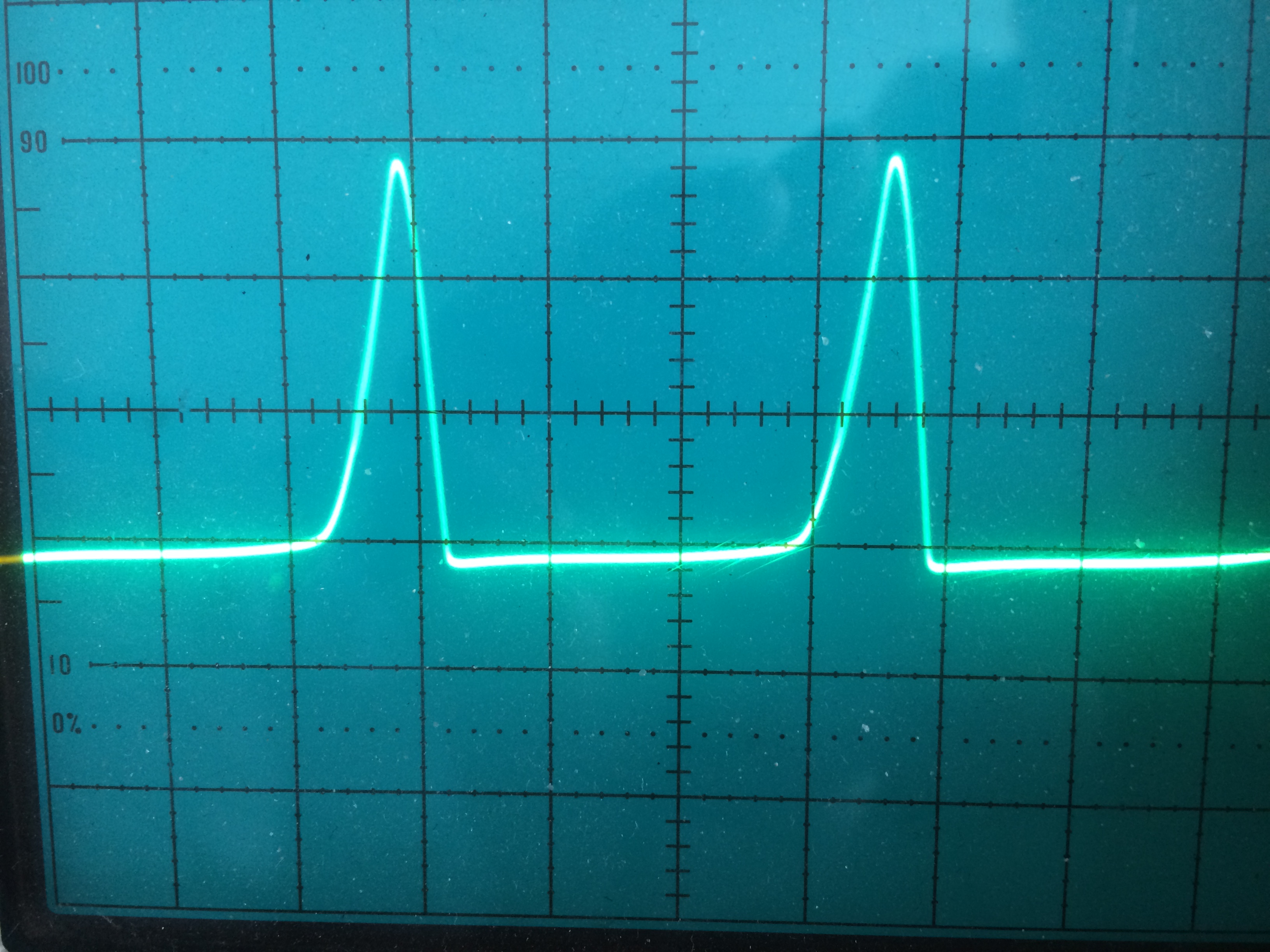

can you post a picture of what you are seeing on the scope?

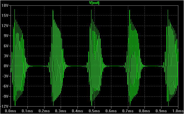

I'm attaching the LTspice trace and the Oscilloscope trace.
Scope probe used is the TP6100 set at X10, 18.5 pF, 10 MOhm, 2V/DIV, 5 us/DIV.
Things are a bit more complicated than I suggested earlier, because the period of the pulses in the LTspice trace is about 220 us, whereas the period of the pulses in the oscilloscope trace is only 20 us. Thus the Oscope trace is not just a filtered/smoothed version of the LTspice trace.
Perhaps the particular parameter values used results in a metastable state, or one that stresses the model assumptions made in LTspice.
that's because the physical circuit is only oscillating in one of the two modes that are present in the LTSpice sim of the circuit. the period is that of the high frequency mode of the circuit in LTspice, not the low frequency "blocking" mode. there's no rectification of the signal going on here, just that the operating point isn't quite right.
