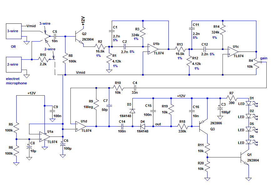

OK, here's the schematic. It has been simulated, but not built and tested. The gain range is huge. Let me know if the range needs to be reduced, or if the gain is too low (which I doubt). I drew options for a 2-wire or 3-wire electret mic. Radio Shack has both types on their web site, with little information on how to use them, and I have little experience with them. If anyone sees a problem, pipe up!

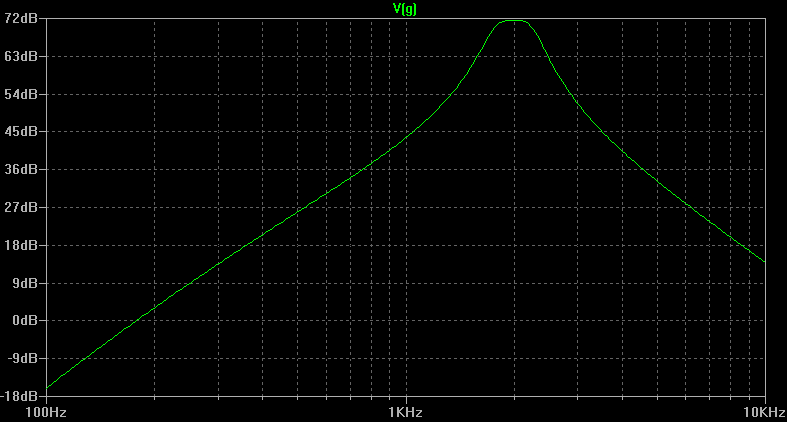

I put a little flat spot on the top of the bandpass filter (BPF) response to accommodate component tolerances and frequency drift from the nominally 2kHz source. This is the reason the twp BPF sections have different capacitor values. If I were building this, I would not relax the component tolerances, because it might mistune the BPF to the point where the sensitivity is impaired.
If you want to use something besides LEDs as your indicator, or you need more of them, or more current through them, etc., post your wishes.
Please let us know how this works if you build it.

Thanks again Ron, as i said, i'm a old school in electronics and i barely remember... but i can see a very detailed and hard work in the picture.
I'm sure it will work, so hands on...
Now i will study the diagram and try to comprehend how it's work, then i will make the list of components to buy and prepare to build.
If it's no diference with the mics, i will use the two wired one... it's cheaper
Just a question: How can i calculate the frequency in the band pass filters?

Here's the frequency response.

Ron, i have more questions (sorry), i'm stuck with the U1a op amp, what is the function of this stage? i gues it's for stabilize the amplitude of the filtered signal but i'm not sure.
Also... what mean Vmid? is this an standard?, i saw that signal is a reference value for the filters and also saw that is a less powerful signal from the mic, but then is involved in U1a stage so... lost again.
And last, which software do you use to simulate the circuits? do they allow to make it work to take measures on voltage, current etc?

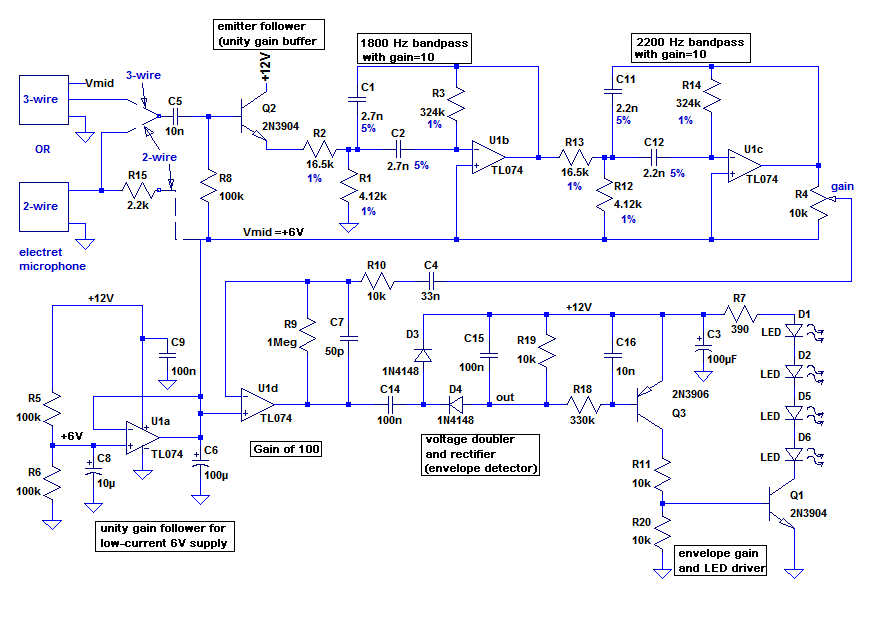

U1a just provides a low-impedance +6 volt supply that can source or sink a few milliamps, if required. Vmid was just my name for a mid-range voltage (half the supply voltage). Op amps work best if their input common-mode level is not near either supply rail (+12V and 0V, in this case).
I simulated this with Linear Technology's SwitcherCAD III. It's free, but you need some experience with Spice-based simulators in order to use it. It does allow voltage and current measurements, among other things.
I'm attaching an annotated schematic, which will hopefully help you begin to understand what the circuit does. Zoom in on the drawing to see all the details.

On your last attachment Did you mean to say 1800Hz HIGH PASS and 2200Hz LOW PASS? I assume that would create a 2000Hz bandpass. But, I must say that seems like a very wide bandwidth that will ultimately hurt the selectivity a bit, wouldn't it? BTW great circuit!! I have never tried to design a circuit from the ground up. I pretty much work things out in a modular fashion, with block diagrams and flowcharts. I usually build circuits that have already been designed, however I guess this is somewhat limiting.
Edit: Nevermind about the filters, I just consulted my ARRL handbook and can clearly see that they are bandpass designs.

Thanks for the compliment - I hope it's not premature.
I actually started out with two identical cascaded BP filters, centered at 2kHz. I then got concerned about component tolerances, so I redesigned the first one for 1800Hz, with a Q of 5, if I recall correctly. The second one is just the first one with the capacitors scaled down by (1800/2200), mostly to avoid having to use more 1% resistor values. It really isn't a canonical 2200Hz filter, but the cascaded combination looks good in the simulation.
