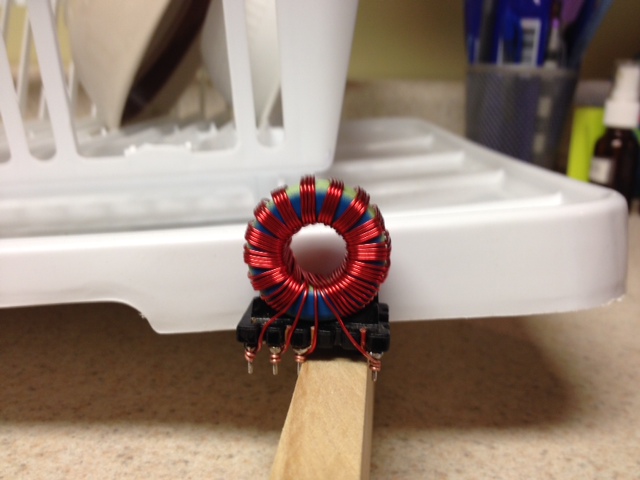

Ok, so I got another transformer rapped and I don't want to heat up the wire to burn off the Varnish.
I thought ok before I solder the wires to the pins, I can scrape the wires with a razor or sandpaper.
But what about finger nail polish remover or Lacquer thinner?
How do you do it?

Here's a pic.

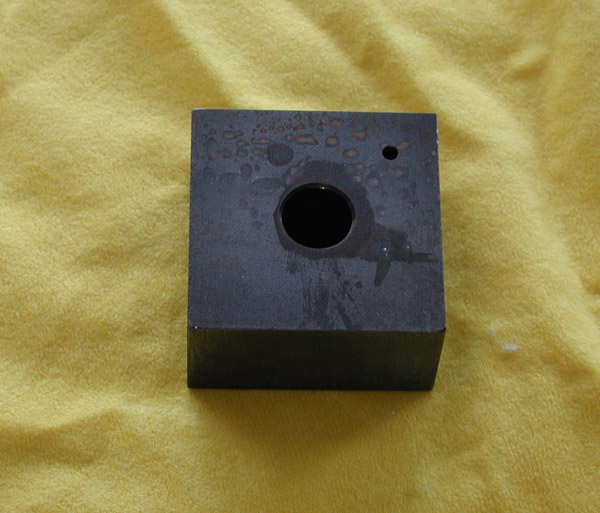

Finger nail polish, lacquer thinner, even "aircraft" paint remover won't work. Assuming you are using magnet wire that is not solderable, I would use either scrapping or a molten salt bath (KOH or NaOH). A little NaNO3 (10% to 20%, not critical) added helps enormously. The reaction is quick and the wires come out bright copper.
Here's a picture of my hot pot:
John

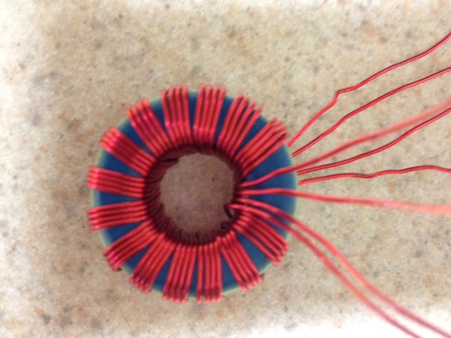

Here's a finished photo, I used emery cloth work quite well.

I tried the both, it didn't work, as you can see I used emery. I'll give the other a go, next time.
Thanks, John.

KilliVolt, Your transformer looks good. You have 1/4 inch of wire between the solder job and where the wires touch. The wire will cool in 1/10 of a inch. In production we wind the wire on the pins and put it in the solder pot. Solder all the pins on one side at a time.

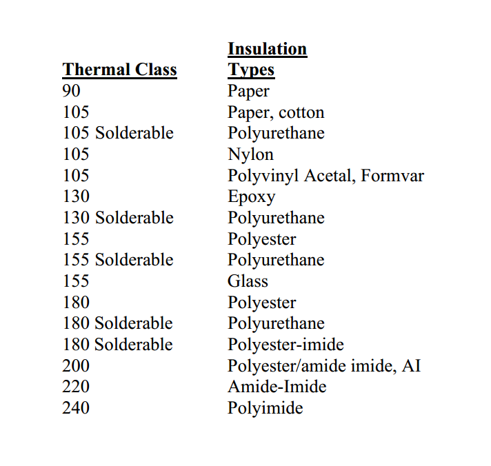

Magnet wire enamel varies according to the application.
The traditional material was Poly Vinyl Acetate and was stable to soldering heat, making it necessary to scrape it off for soldering.
A later material was Polyurethane which is unstable to heat but good enough for many applications where the temperature rise is not great;eg. small coupling transformers,HF coils, etc.. It is used extensively in appliance products because of its ease of tinning/soldering.
For really high temperature work, polyester materials are used. eg power transformer for say steam generators. Needless to say, the development of new solderable AND high temperature, materials continues.
Mostly for what we do here, polyurethanes are good enough.

Here is a listing of some common insulations from Essex with temperature ranges: **broken link removed**
