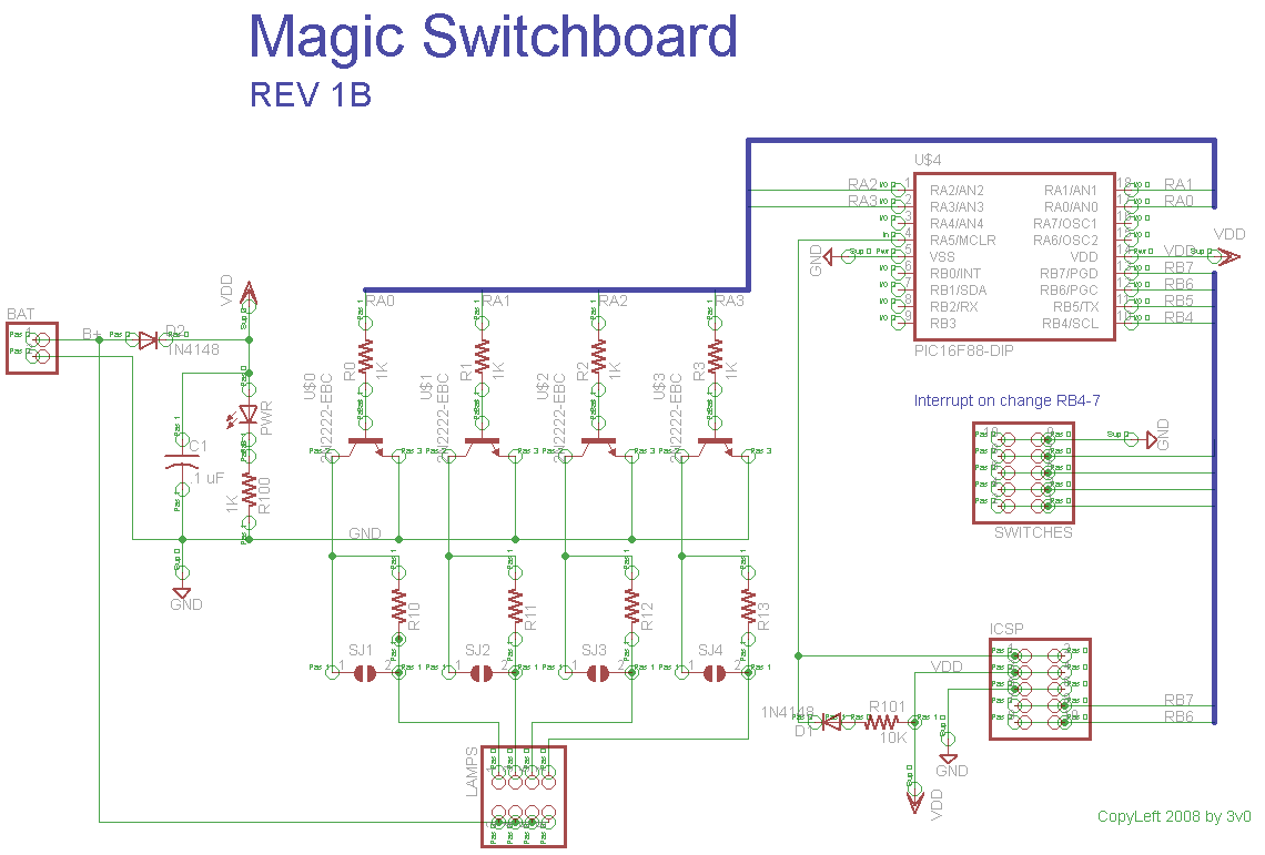

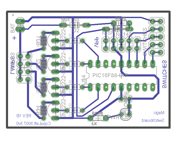

Schematic
First cut of a schematic using 16F88.
Power with 4 cells.
To use with bulbs bypass resistors R10-13 with junpers JP1-4.
If you choose to use LEDs you need to polorize the sockets.
This should be easy to etch and solder.

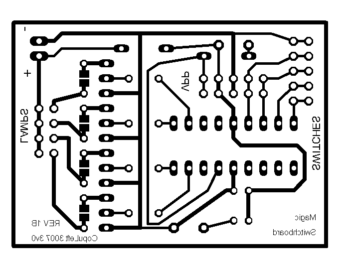

EDIT: Current version is 1B which uses SMD Jumpers
Board is aprox 2.0 x 1.5 inches
Updated schematic
Added board and foil images 300dpi
Will post eagle files if requested

Students will like it, but the real fun will be the other teachers.:D
Sort of funny. You doing the programming and me the hardware.....
EDIT: If you want a board I can make two. Connectors are all .1 pinheaders.
I'd love a PCB, and thanks Marks256 for the food colouring tip.
PS the code will be interrupt driven, of course you can change it as it'll be trimmed down to simply work.
Two interrupts,
TMR0 (about once per second) will update a counter and sleep / reset
INT_on change PORTB for the switches
That's all you need really.

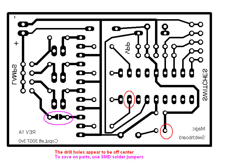

3v0 said:
Board is 2.3 x 1.5 inches
Updated schematic
Looks good. Just a few thing things I noticed. The drill holes on some pads appear to be off center for some reason. You might want to use SMD jumper pads to keep costs down:

kchriste:
Thanks for looking.
I do not plan on making more then a few boards. On the ones where I know LEDs will not be used I will put traces between the pins of the jumpes.
What I posted was generated by Eagle's EXPORT>IMAGE. I do not think the holes will be offset if I print it directly from Eagle. The again it was the new beta version,
