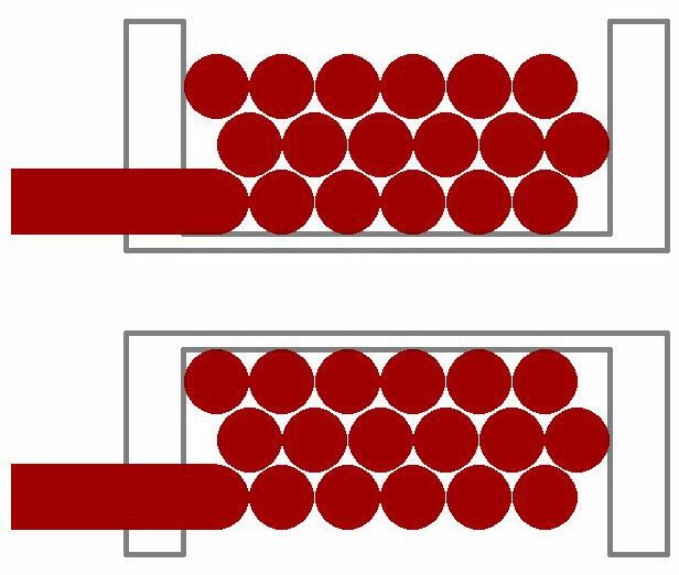

Hi greameian,
when you finish the first layer the second one will automatically come up and occupy aproximately 1/2 of its wire diameter in height. This is exactly the point where the follow-up windings should continue. The 2nd layer will then fill the gaps formed by the 1st one and so forth.
Don't force the windings together, just lead the wire to a position where it aligns automatically.
For clarity look at the picture.
Also compare the technique of level winding by slowly unwinding a role of soldering tin. No matter how many windings, the result should be without dips and bumps.
One bump messes up the entire look of a coil.

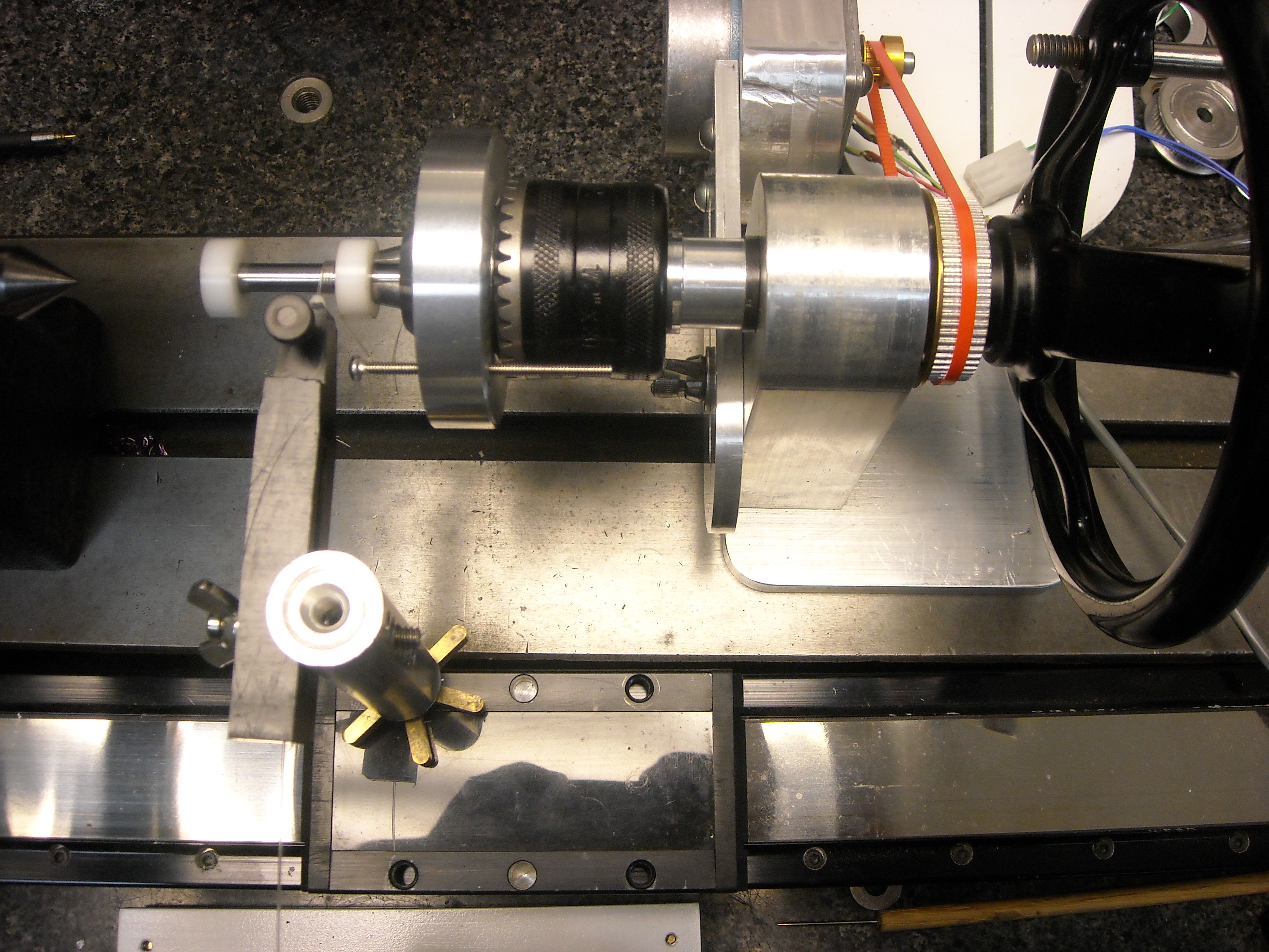

I am fabricating my automated winding device. I am almost complete on the project. My winding speed should be about 2-6 Hz. The rastering speed will be calculated from the winding speed and the pitch. For example, if the bobbin length is 1 inch and it takes 70 turns, should my raster travel be 1 inch left and right per 70 turns or should each consecutive layer have a shortened raster distance?
Use a rastering according to the bobbin effective length. The moment when the follow-up layer of wire "towers" the lead-in will already move in the opposite direction.
Thank you Boncuk et.al. I completed my wire winder last week. It can operate in two modes. One method uses a simple automatic rastering method. I am using two stepper motors and a PC to generate the pulses. The winder makes some turns and the raster moves left to right. Since the raster step motor is so slow. I do not have to worry about acceleration. The other method uses a hotkey to manually reverse the direction when the wire "towers".
Attached Picture
I hope you can see the picture. (Winder.jpg)I used the attachment feature. I am using fishing line in the picture because it was what I had available. It is Sunday morning and I did not want to waste copper wire for this photo. You cannot see the clutched spool. The wing nut holds a black Delrin arm with a through hole with a white Delrin insert just over the spool. Inserts are made for nearly each wire size. The gold spider nut is attached to a linear slide which is driven by a stepper motor. To get my gauge or scale settings, I hand wind a full pass keeping track of the number of turns and measuring the width of the spool gap. I put these numbers into my VisualBasic program along with the number of layers needed. I have made four layer coils using large 22 awg wire and they look great. When I get in the high 30s awg sizes, I see where the wire winds over the wire below and I get the spiral "bump". The important part is that I can make two equivalent coils which was my aim.
