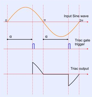

The cheap adapter probably uses a simple triac circuit (like in a lamp dimmer) to make a symmetrical mess of the sine-wave:
Many computer power supplies and switcher mode wall wart power supplies for chargers will run on 120v or 240 vac. There are adaptors that are just plug to socket changers that allow a two spade prong 120v plug to be connected to the European 220 vac. You get direct connect so what you plug in gets 240 vac. You have to be careful on their use to be sure what you plug in can take 240 vac. Again, these are fine for a laptop power supply that works on 240v or 120 vac. The primary determiner is the voltage rating of their power supply's filter electrolytic caps after the input rectifiers. How do you tell, first look at the label for input voltage. If it is relatively large and heavy it is an old power transformer based wall wart and will not work. If it is relatively thin and light it is likely a switch mode power supply and will likely take the 240vac. But check the label to be sure. The old transformer based wall warts actually cost more to manufacturer these days then a switch-mode power supply so you rarely see the transformer based wall warts supplied with new equipment.
Next level is the triac based power converter. As shown in Audioguru diagram they trigger at a partial point on the sinewave where the voltage is lower. Not all devices like these converters. An AC syncronous motor like a refrig compressor would not like these converters. An electric motor with brushes, like an electric drill, hair drier blower, will work with these converters. Heating devices are okay with the choppy waveform. They can also create RF interference to radio/TV equipment. They need a minimum load to cause the triac to conduct and latch on. Once the triac is triggered on, the triac is latched on and turns off at zero current crossing. This is why you cannot just measure open circuit, unloaded voltage with a high impedance DVM. Even with a load you need a true RMS meter. Most inexpensive DVM are AC averaging which will give an incorrect reading of the non-sinusoid shaped waveform. All triac have about 1.5 to 1.8 volt of drop across the triac. If you draw a heavy load like a hair drier they can get very hot. A 10 amp hair drier times 1.5 v triac voltage drop produces up to 15 watts of heat to dissipate by triac. This is quite a bit of heat for a small packaged converter to dissipate to surrounding air.
The last is the power transformer. Relatively small wall wart sized transformer are only good for 10 to 20 watts which is good enough to run an electric razor or charge a phone. You can get bigger and bigger transformers, for higher and higher cost, that will handle whatever wattage (actual VA) you want. A 2 kVA auto-transformer will cost you several hundred dollars and weighs about 25 lbs. An auto-transformer wiring configuration allows a transformer size of half the size of a full isolation transformer.
