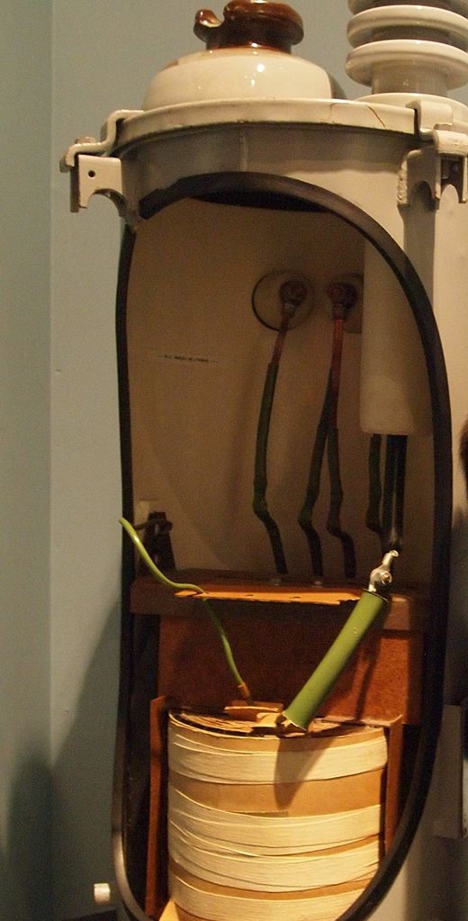

Here you go;
Its mostly just a can with a transformer inside.

i am a bit disappointed! dont know what i expected but it was more than that! still would have kept me in copper wire for a bit .
Not necessarily. If it was made in the last 50 years the odds are it's all aluminum or copper clad aluminum windings.
Enamelled square wire for the primary and flat sheet for the secondaries.
Damn near useless for most anything else electrical or electronic. :(
