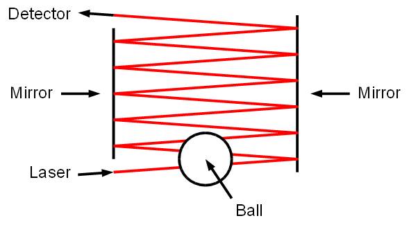

Perhaps if you posted a sketch on how you see these mirrors are arranged, I will discuss it with you.
If the beam is set wide enough to cover the expected limits of the balls path thru the beam then how would it jump over the beam.?
But if the beam is larger than the ball then surely the ball won't completely obscure the beam?
Of course it would reduce the intensity slightly but will it be enough to detect?
If it clips the side of the beam it might not be enough to trigger it, so doesn't that mean the beam needs to be larger than the area you want to monitor?
Here's a sketch of my mirror idea.
I've not done this before so you could be right, it might be a bad idea.
I can see where you are coming from with the mirrors, but I would think the alignment and quality of the mirrors would have to be first class.
Also the reflected angle would have to be less than the ball diameter in order to ensure that the ball didnt pass thru a gap.
We would have to know the working width between the two mirrors.

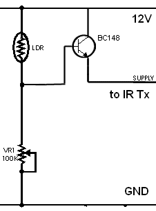

ah thanks Ill try look more into that. I have to figure out how to make the LDR give me 8v in shade and around 11,5v in direct sunlight. I do have some ideas for that.

Look at using a voltage comparator circuit for your LDR (cDs cell).
very simple to build.
