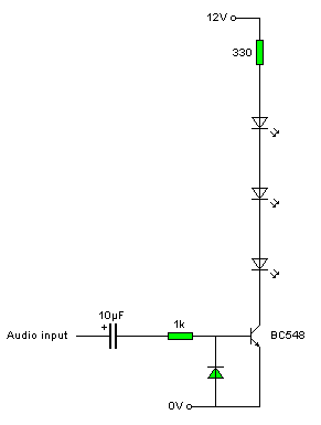

Here's some schematics from the thread.
**broken link removed** **broken link removed**

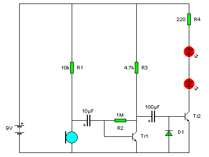

Here's a circuit which uses a microphone so doesn't have to be directly connected to the output of the stereo.
If the lights are more than just a few LEDs, you'll need to add another transistor to boost the current.

I like the idea of using a microphone instead of a stereo output...in the schematic can you specify what transistor, microphone, where the lights go, etc?
