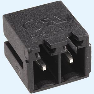

I'm just starting out learning electronics and bought a kit with a bread board. I getting tired of just sticking the leads from the battery clip into the bread board. Is there something like a mini plug I can purchase that I can hook the lead into and then just plug it into the bread board? Or does anyone have an idea how to make one from other parts?

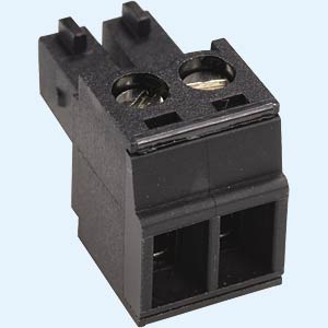

using a normal DC-power jack will ruin the breadboard, just because the solder lugs are 0.4X2.4mm.
Here is a nice method to reliably connect the power source to the PCB. The female plug (with supply voltage) fits onto a male connector mounted on the PCB. The pin spacing is 3.81mm (0.15inch) and they can handle 4A of current flow. Those connectors are made by RIACON. For more info: RIA CONNECT - smart design in components - Home
For clarity take a look at the pictures attached.
