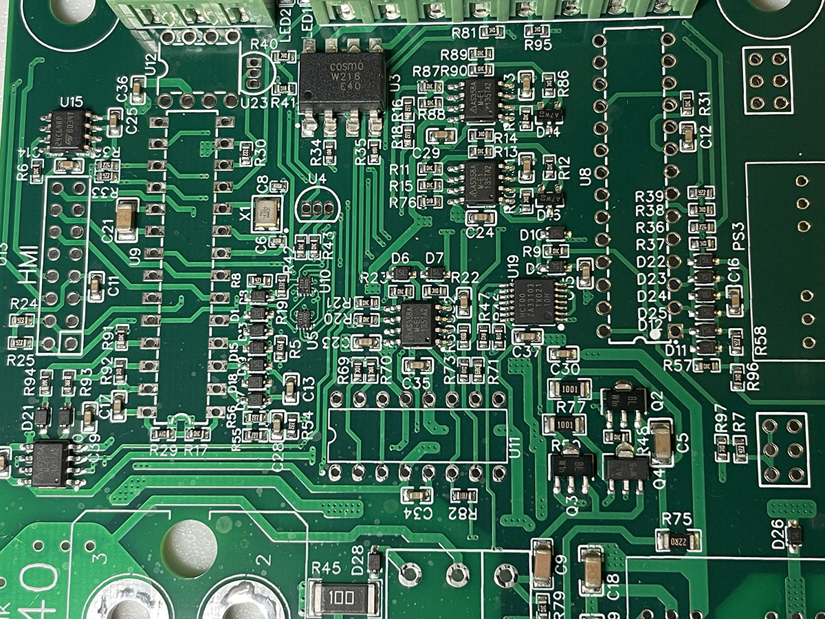

Why not use JLCPCB and get them with most components already fitted?
It's usually cheaper than buying the parts separately, from my experience?
eg. This is part of one of our prototypes, a four layer one, just as received:
Thanks for the suggestion. I will definitely be looking into that option for the motherboard. That would be great if I could get it cheaper and with all the surface mount components already soldered on. Might be worth the wait on shipping from China.
