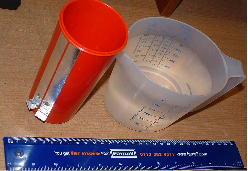

Earlier I wrote:
As a quick and dirty test, try putting the plates on the side of the container, adjacent to each other with a 3 or 5mm gap.
So I did, as shown in the picture below.
The silver coloured strip is something made by a company called Chomerics, I think that it is called "Cho-foil" and if I remember correctly it cost a fortune.
The stuff that I have used in the past could be soldered, but this stuff (which I got in a box of junk) does not seem to like taking solder.

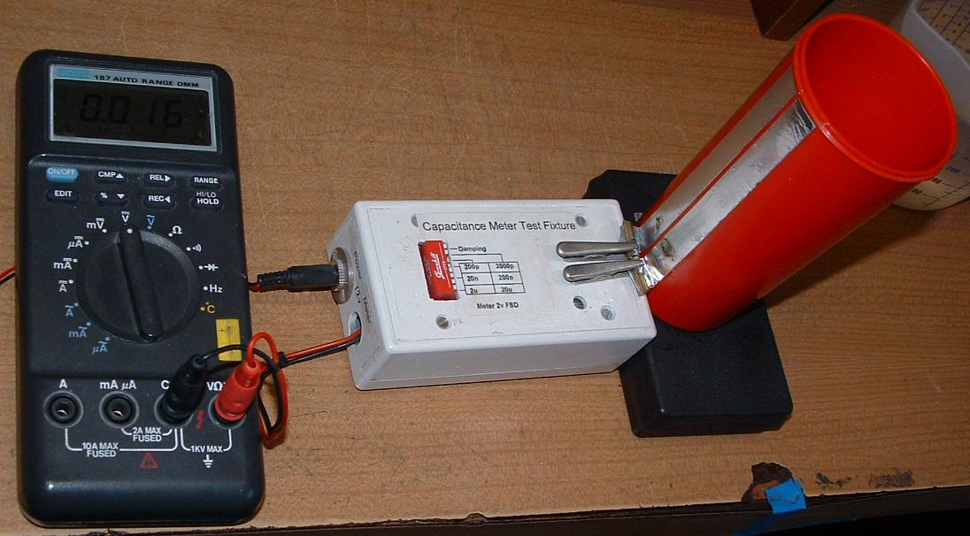

I then connected this to the capacitance test jig:

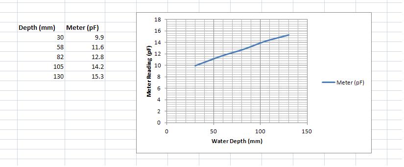

Adding various amounts of water and measuring the capacitance, gave the following results:
Not a big capacitance change, but measurable and repeatable.

I thought that I had just done that! (See post #12 in this thread).
