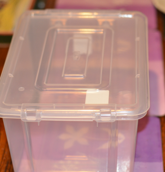

ok quick and dirty test with 2 PCB boards on sides of container, i havnt taken measurements because i cant get in the kitchen for long enough until after dinner :rolleyes:
but quick test revealed that both pcb's on same side gave higher reading (seems right) but i get a lower reading but more variation with depth with a pcb on each side!
i will wait until tape gets here for proper test but is looking good! main concern is the fact that a ultra sonic fogger will be in the water and when its on i am expecting it to really affect the readings, also the water changes alot withing a couple of days of the fogger being in it. There seems to be alot of rod shaped bacteria build up on the fogger and the water clouds more than a plain container of water, the first problem of the fogger being on is easy to solve as i will use the micro that switches the fogger on and offf to do the reading for the capacitor, that way i can get it to do the reading when the fogger isnt active! the bacteria problem i wont know about until i try it for real with the tape, 18f chips have the CTMU as part of the ADC port (port A) wich is 10 bit, i might use a 30f because the CTMU is part of the 12 bit ADC on portB, so i will have more resolution. But i will try both and see if there is any difference, so next on reading list over next few nights is CTMU in the datasheets and see what they can do

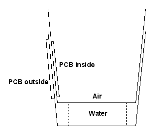

To increase capacitance the area of overlap of the two copper patches (e.g. pcbs) should be maximised and the spacing between them should be minimised. Here's one approach, using a pair of flat-sided thin-walled plastic containers such as margerine tubs, with the water in between the two containers, one patch inside the inner container, the other patch outside the outer container. Neither patch is in contact with water:-

In that case a cap could consist of a horizontal pcb on top of a float, with a fixed pcb just above and parallel to the first pcb.

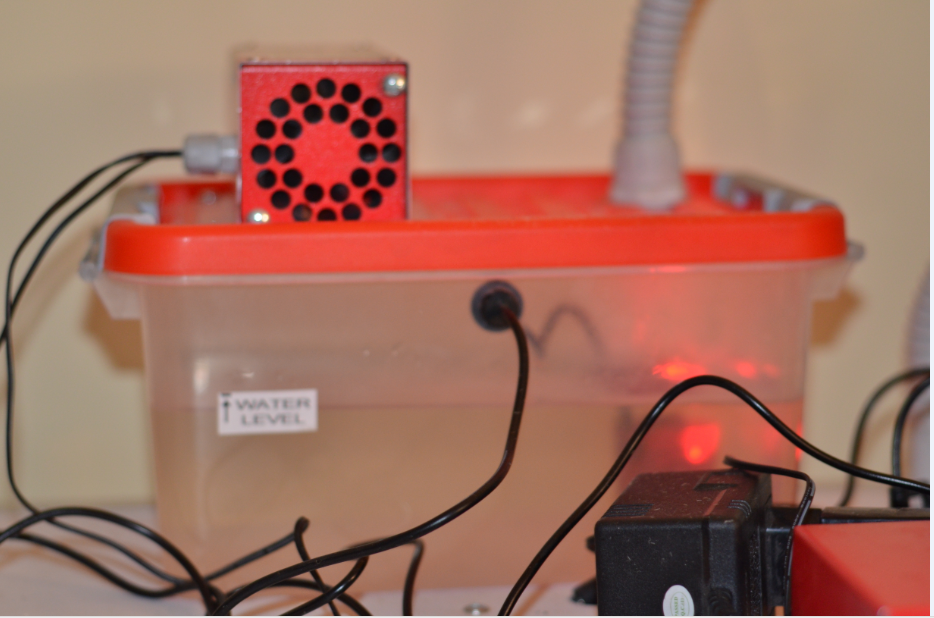

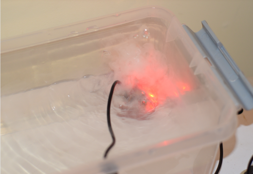

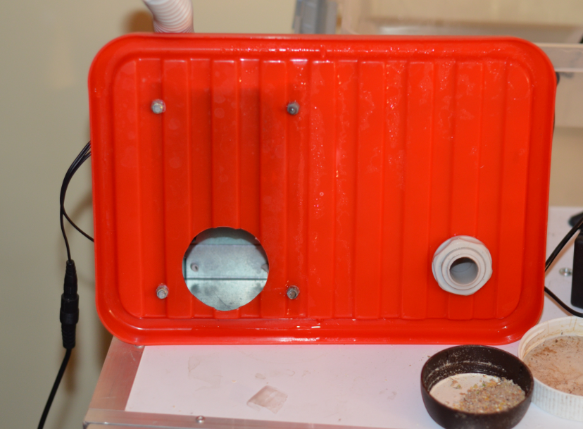

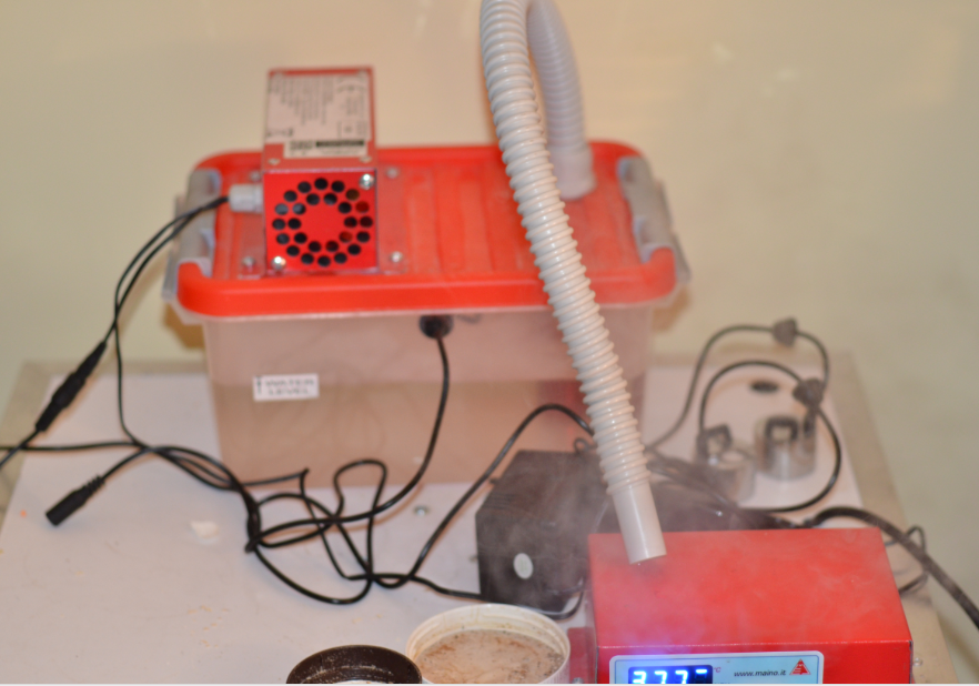

ok got some pics
this is the commercial unit they charge over £100 for this!!!!
in the second picture you can see the fog coming out the end of the pipe, the great thing with this is the fog is so fine it actually feels dry! but is very fine water vapor so is brilliant for upping the humidity in the incubator
the only bit i cant seem to find online to buy is the connector for the pipe that fits onto the lid! it swivels as well, so if anyone knows what they are called, the fan dosnt sit over the hole its at the other end but works really well
and the box i have is slightly smaller
