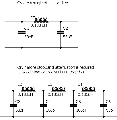

As I mentioned in an earlier post, a simple "pi" section LPF can be designed as follows.
Choose the 3dB cutoff frequency.
Choose the filter impedance. In this case 50 Ohms.
Calculate the inductor value using Xl = 50
Calculate the capacitors using Xc = 50
So if we made the cutoff frequency 60MHz:
Xl = 50 = 2 x 3.14 x 60 x 10^6 x L
Which gives L = 0.133 uH
Xc = 50 = 1/(2 x 3.14 x 60 x 10^6 x C)
Which gives C = 53 pF
The example I have shown here is something which I used recently with an ADF4351 which I was using for a 50MHz source which had to be free of harmonics.
If you are intending to create frequencies of 100s of megahertz or into the GHz range, the form of the filter would have to be selected accordingly.
Try building this simple filter in your MATLAB simulator and see what happens.

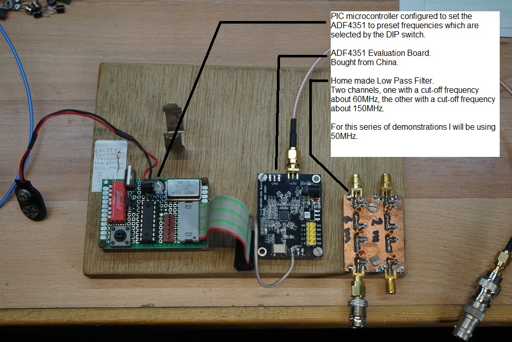

Time for a little bit of "Show and Tell"...
My ADF4351 test setup.
It has many things which are not very good in terms of RF performance, but it does what I wanted it to do.
Close up on the ADF4351 Evaluation Board.
The coax cable coming in on the left hand side is from the 32MHz oscillator mounted on the PIC board.
For what I wanted to do, using as 32MHz clock rather than the 25MHz clock built in to the eval board, made programming the frequencies that I wanted much easier.

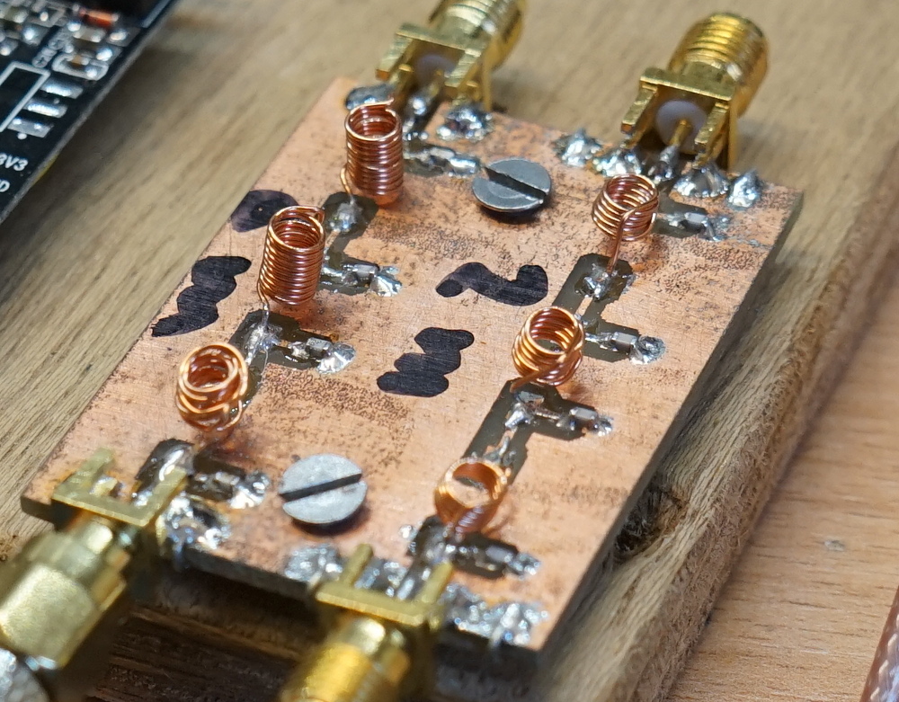

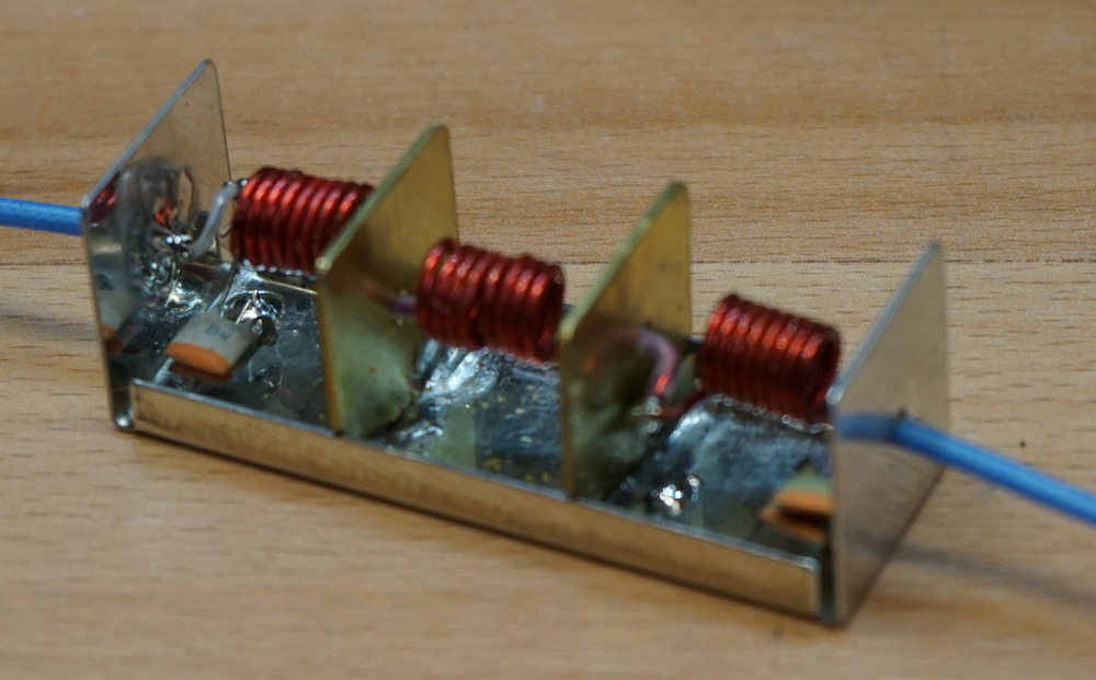

The Low Pass Filter.
Some of the coils are a bit battered due to rough handling.
This is basically the same as the three pi sections shown in post #26 above.

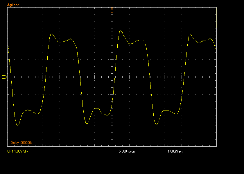

Using an oscilloscope to look at the 50MHz output of the ADF4351 we see this:
A rather distorted square wave.

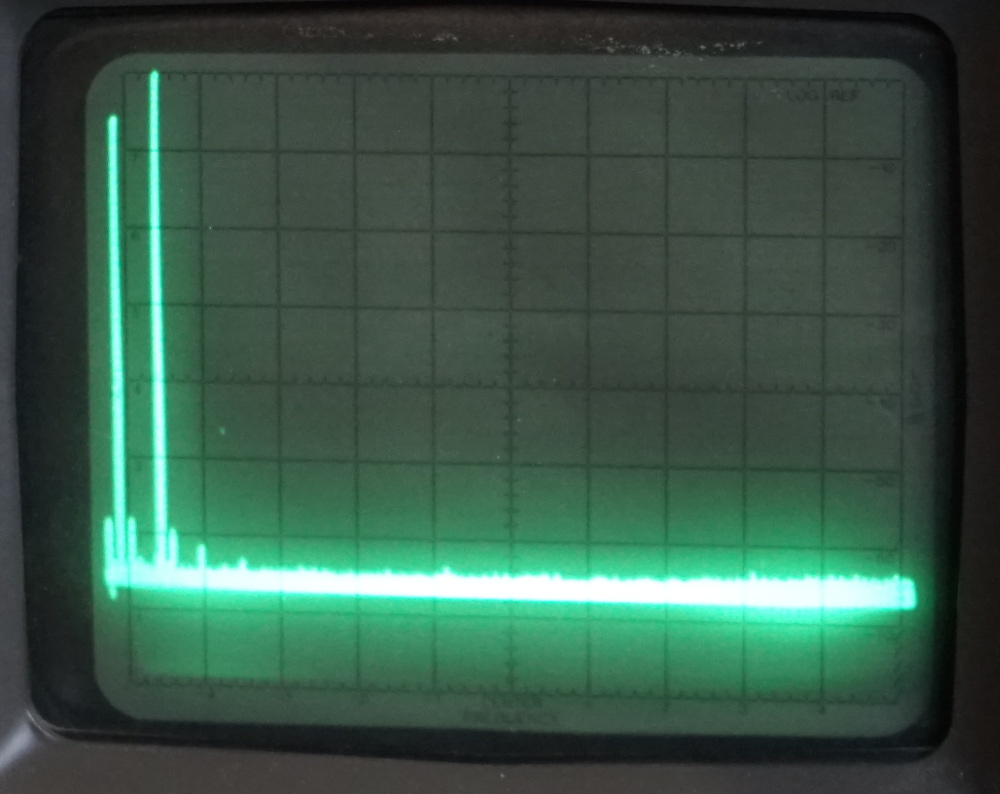

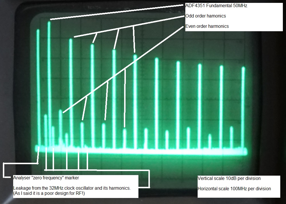

On the spectrum analyser, it looks like this:

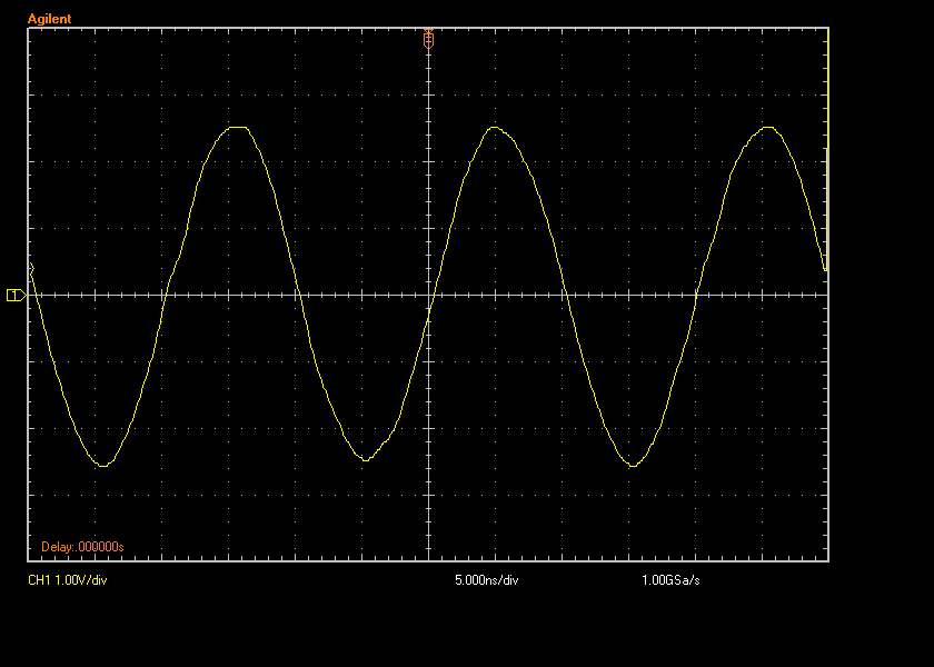

If we now pass the output of the ADF4351 through the LPF
On the oscilloscope:
A much cleaner signal with the harmonics suppressed better than 60dB.

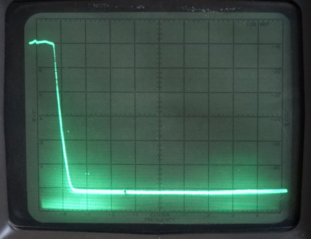

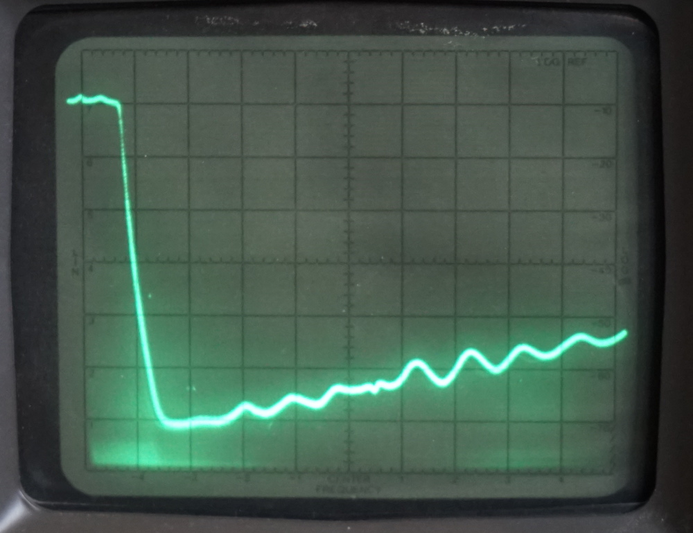

Using the spectrum analyser and tracking generator we can plot the response of the simple LFP
A reasonably flat response up to 60 or 70MHz, a steep fall off into the stop band with 60dB attenuation up to about 250-300MHz when the response starts to rise up to about -45 dB at 1000MHz.
Probably to be expected from a simple filter with no screening between stages.

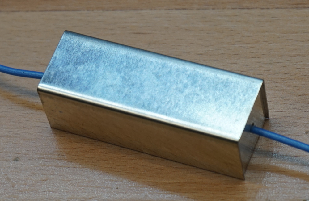

Sometimes we need a better filter.
Like this one:
Looking inside:
Uses larger components than the simple filter, but this one was intended for use with a 50Watt transmitter.

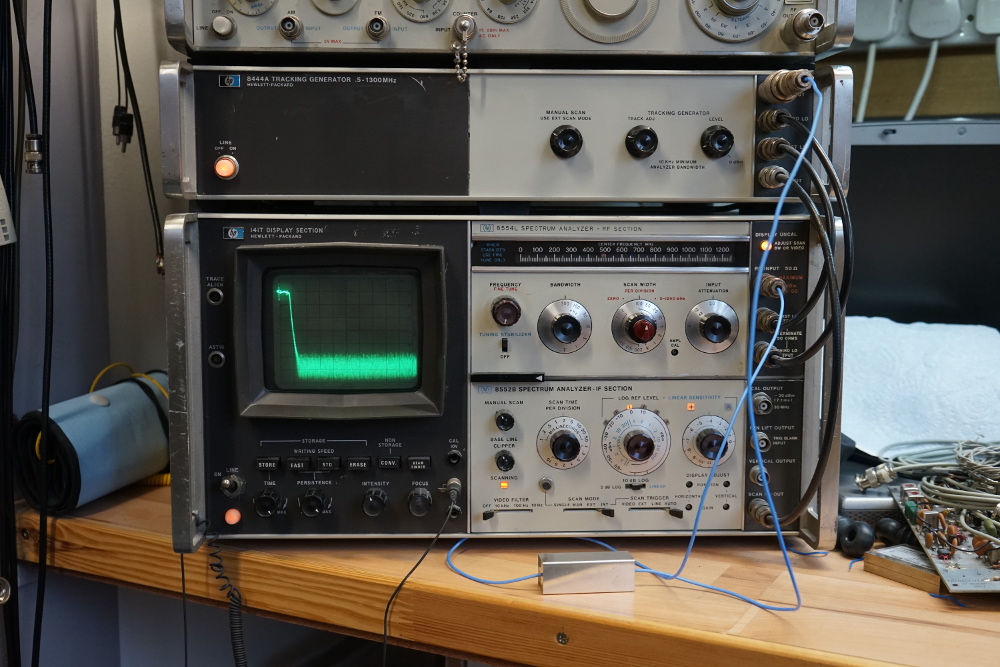

Using the spectrum analyser and tracking generator we can plot the response of the simple LFP.
Hola Jim
If it is not deemed derailing the thread, could you outline briefly how you did it.
Thanks.
Hola Jim
Hola ATF
Si, de nada.

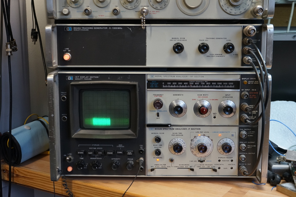

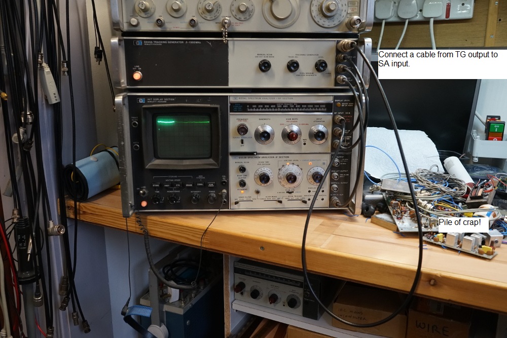

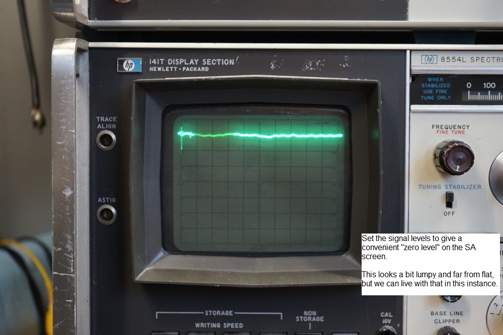

The spectrum analyser (SA), the tracking generator (TG) sits on top of it.
The cables on the right hand side connect various oscillator signals from the SA to the TG so that the TG outputs a signal on the frequency to which the SA is tuned.
Connect a short cable from TG output to SA input, and adjust the various controls to give a reference level trace on the SA screen.
My preference is to use the -10dB line (second from the top) rather than the very top line of the screen.

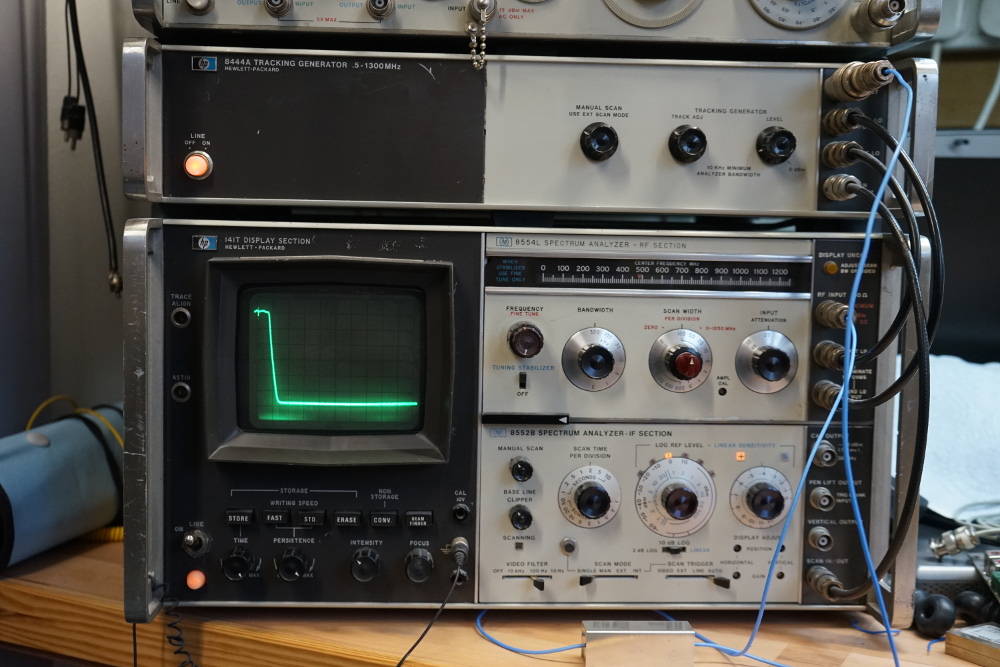

Now replace the short cable with the filter to be tested.
Looking good, but we can improve the display and get rid of all that "grass".
Switch in the video filter to remove the low level noise, and set the display to storage mode to give a nice stable image for the photograph.
And that, briefly, is how I did it.
