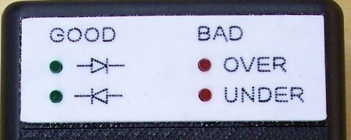

Yet another way to do it is to blast a jillion .012" diameter holes in it with a laser engraver, paint over it with contrasting color, and then sand it down. Here's one I did that way -
The advantage here is that the lettering never wears off, or peels up - makes it especially good for hand-held devices.
Disadvantage is you need a laser engraver.

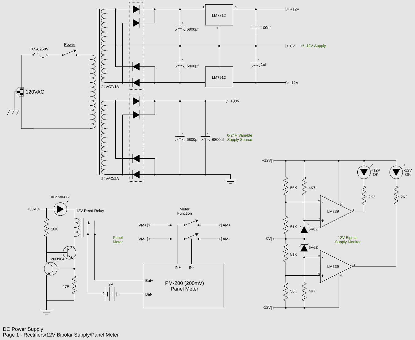

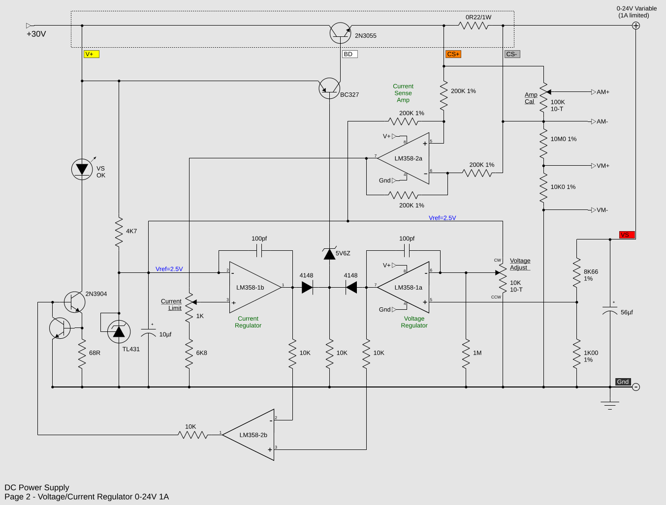

Hey Modemhead, i don't suppose you have the circuit for this power supply you built by any chance? it looks really nice and is just what i need?
Neil.
well the image didn't transfere to this post, but i am refering to the 0-24V one.
Neil.
That could be arranged, however I'm away from home for the holidays and don't have access to my files, so it will be a while until I can share it.
Here you go. Keep in mind, this is junkbox engineering, ie. some "design decisions" were based on what bits I had laying around. It's based around a dual-secondary transformer that came from Electronics Goldmine. Unfortunately it looks like they don't stock it anymore.
