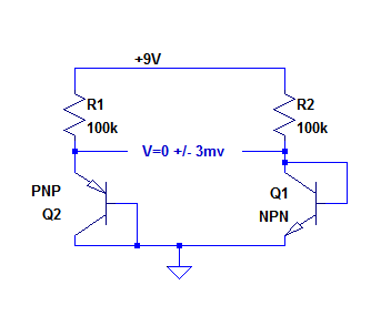

Yeah, there are diode ladder filters too, and there is one where the filter uses transistors connected purely as diodes (the roland tb303 one I think does). This one does use them as transistors in the ladder, not purely diodes, but the transistors that need the matching arn't actually in the ladder. They appear to form part of the voltage control circuitry. Perhaps it assures it tracks at 1v per octave with the resonance on, otherwise the key tracking might go out as you went up the scale. For me, that isn't too important actually as I intend it as a stand alone unit, but I want to do it properly; is there any simple way to measure the vbe voltage? I only have a multimeter to use. Yeah, it is a confusing circuit, i'm not certain how it works myself, quite an ingenious design.
This should get you close enough. If you're really picky, you could match the resistors first. They don't have to be exactly 100k. They just need to be the same value, say +/- 1%. Any voltage between 9 and 12 should be fine.

Ok, I matched the resistors first, then tried the various 3904 and 3906 I had. I only currently have about 8 of each, but found a pair that read 0.601 and 0.600v respectively. The last digit there represents the mv, so they are within the +/-3mv of each other needed. The temperature certainly changes the readings I noticed, so I left them for some time to settle after touching them.

That sounds good. On the schematic, I was indicating that you can also measure the matching differentially. Put one probe on one tranny, and the other probe on the other tranny.
