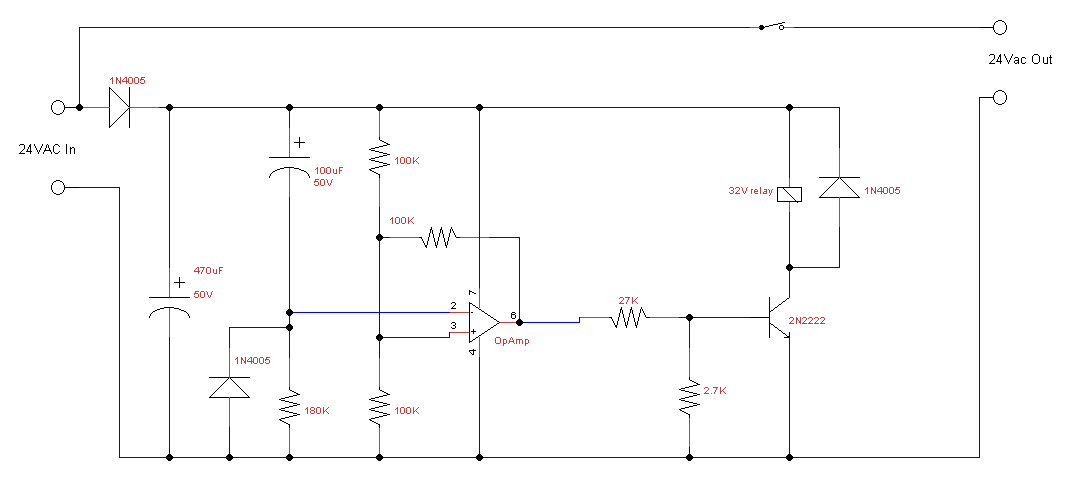

All I need to do is delay power to a relay for 40 seconds (+/- 5), after that the power to the relay coil should come on and stay on until the whole system is powered down (anywhere from 12 minutes to 120 minutes later).
The power coming into the system is 24 volt AC. I need it to be as small as possible, so the less number of components the better. It will be in a small, waterproof container. If I could cause a delay without conditioning the electricity (taking up space and causing heat) I would do that. So kcristie's idea appeals to me. How does it work and can I get 40 seconds of delay out of it?
That might work. I forgot to mention I'm trying to keep the cost down around $2.00. I'll send off for info. I'm very curious as to how they did it.
Something like this should work:
delay-png.29949
For the OpAmp, you need to choose one with that will operate up to apx 40V or higher just to be safe. Something like the MC33171 or equivalent will work. The timing tolerance will be dominated by the tolerance of the 100uF capacitor. You can change the 180K resistor to compensate or sub a 200K pot and a 100K series resistor.

The part that user 88 sent me to is great except it's too large. The delay that kcristie put up is great, and I like keeping everything at 24vac. I'm a bit intimidated by it at this point, but I have Sunday off, so I'll probably have to give it a try if I can get all of the parts together.

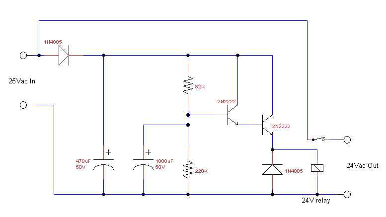

If you can't find a 32V relay, you could use a 24V one in a pinch. For example, if the 24V relay has a 2000Ω coil then you could add a 680Ω resistor in series with it. In a circuit like that, the resistor would only dissipate 0.1 watt which is negligible. Generally speaking, the higher the coil voltage of a given type of relay, the lower the required coil current is going to be which is why I suggested a 32V relay.
Yes, to increase the timing period you can increase the capacitor value (220uf --> 330uF) or the resistor value (180K --> 270K). I just realized I goofed on my timing calculations earlier. The original 100uF should have been 220uF for apx 43 seconds of delay.
While that would work, the timing wouldn't be as consistent with voltage variations and the relay wouldn't be as "snappy". But since you mentioned it:

Well, if the timing was within say +/- 8 I could probably live with it by jacking up the total delay. It appears at this point I just don't want to be less than 40 seconds. So if I could be close on timing without generating a lot of heat, taking up a lot of space, or costing much money I'd be happy.
Dallas90,
The timing will vary with changes to the 24Vac if you use the transistor only method. So as the line voltage changes, the 24Vac will change, and thus your timing will change. How much is difficult to say at this point, since things like relay pull in voltages are unknown. You'd have to build the circuit to be sure.
why not change the 2 2N222's for a Darlo.....?
Yes, you could do that. Most people are more likely to have a pair of 2n2222's or other NPN transistor on hand rather than a darlington.

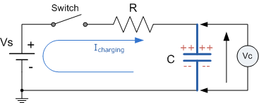

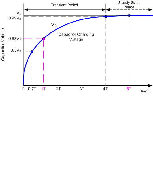

Could someone help me learn here, by walking me through the operation of the circuit? It appears that the delay may be caused by the charge time of the capacitors and the switching by the transistors , but it's not totally clear to me.
To keep things simple here's my take on it....
Without going into all the maths behind it the time taken to charge a capacitor to a given voltage is defined as the time constant... usually 63ish % of the supply voltage...ergo if you change the voltage supply the time will change although the constant doesnt....because it is fixed...Look at the drawing....and then look at the graph....
If you keep the value of the capacitor fixed and the same resistor, changing the voltage changes the shape of the curve...Fixing the voltage and changing the resistor has the same effect if the voltage remains the same...Got it?
