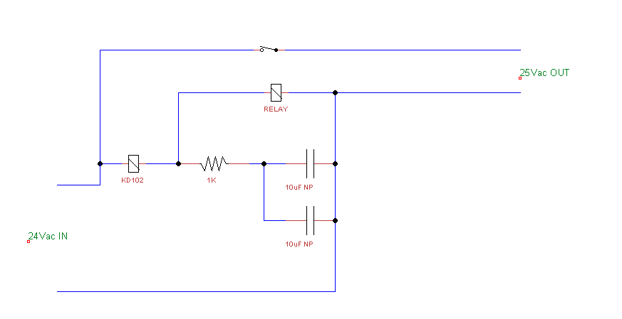

As a sidelight from the simple/no heat/ cheap delay problem. I have a delay module that I threw onto the circuit board of my prototype and now I need help with that. It is a pass through module, or to say it is in between the 24v and the power to the relay, after 40 seconds the power is allowed to flow through and the relay closes. Problem is, with the mini relay, I'm getting chatter during the 40 second delay period. After some research, I threw a capacitor 100 µf 50V and a resistor 1w 100Ω on it (across the coil). It worked as it should (no chatter), but the resistor smoked about the time the relay opened. More research reveals that the coil (24Vac) has a resistance of 350Ω and draws 25.35mA. I did have a 390Ω 1W on hand and while it didn't smoke (at least not after a minute or so) it was getting warm so I shut it off. (too early?)
Am I way off on R or C, or am I leaving something out?

KD102 set to 40 seconds. I've tried a few combinations of resistors and caps, I still haven't found a combo that does away with the buzzing coil but results in a manageable amount of heat.
Does you your relay buzz when operated from straight 24Vac without the KD102?
If the relay buzzes when it is supposed to be off, the problem may be that the KD102 has a minimum loading requirement. ie: It does not turn fully off because it draws power through the load (Your relay) when it is supposedly "off". If this is the case, try putting a 24V 50-150ma light bulb in parallel with the relay coil.

Well, I had very little time (no time to go to the store) so I pulled the pins out of a (12V) automotive brake light and shoved the pins into the breadboard. It worked, the relay didn't chatter except for a millisecond or so at switchover.
Now, do I HAVE to use a lightbulb or is there a more elegant solution?
If your load draws 500mA or less, then you don't need the relay at all and can use the KD102 as the switch.
Your KD102 needs minimum of 20ma flowing through it when it is on and it leaks 2ma when off. That is why the extra load of the light bulb gets rid of the buzzing. You could try different resistors of lower and lower values (start at around 1.2K) instead of the bulb to see where the buzzing stops. You'll need a resistor of sufficient wattage though. P = E²/R so a 1000Ω resistor will dissipate 0.576 watts at 24V therefore you'd need a 1 watt resistor since the next lowest wattage is 0.5W. ( 24²/ 1000 = 0.576 )

Well, here's the report for today. I'm off the the electronics store again to buy more resistors. the 2 x 2.2k 1/2 w in parallel still allowed the chatter although at a much lower frequency. The single 1.2 was about the same. As was 1.0 and 820. 820 was the lowest value I had, and almost caused the buzzing to stop but it also got pretty warm in the next few minutes after the relay switched. I'm now afraid that I'll have too much heat after I get rid of the buzzing. Very frustrating.
Now I'm trying various values in series. So far, if I get a value that stops the chatter in the delay period, it chatters when it supposed to be on.
Very strange. I'm kinda stumped here too. You might want to contact the manufacturer of the KD102 and ask them about your problem. Include the part number of the relay and how it is wired.

You may want to experiment more with the 330Ω RC snubber network. It would help to have a handful of non-polarized caps on hand for that as you'd have to experiment a bit.
I've been working in an unairconditioned garage and it was 102 today so I may not have been at my sharpest at all times, but I tried quite a number of combos. I'll try some more tomorrow, I don't have a scope so I can't look at the waveform, and I've been thinking of trying to get some different relays.
O.K. As of 1:00 CDT have a working solution. I get about 10 seconds of very light chatter (so light that it might not hurt the project) and a nice solid, on time switch over. I'm using the KD102 and putting a 1.0K 1w resistor and 2 non-polar 50v 10uF caps in series with the relay coil. There is no overheating after switch over. I would love to get rid of the minor start up chatter but at least I feel like i can make progress on the prototype.
Any ideas on the start up chatter?
Just to clarify, is this what you have?
