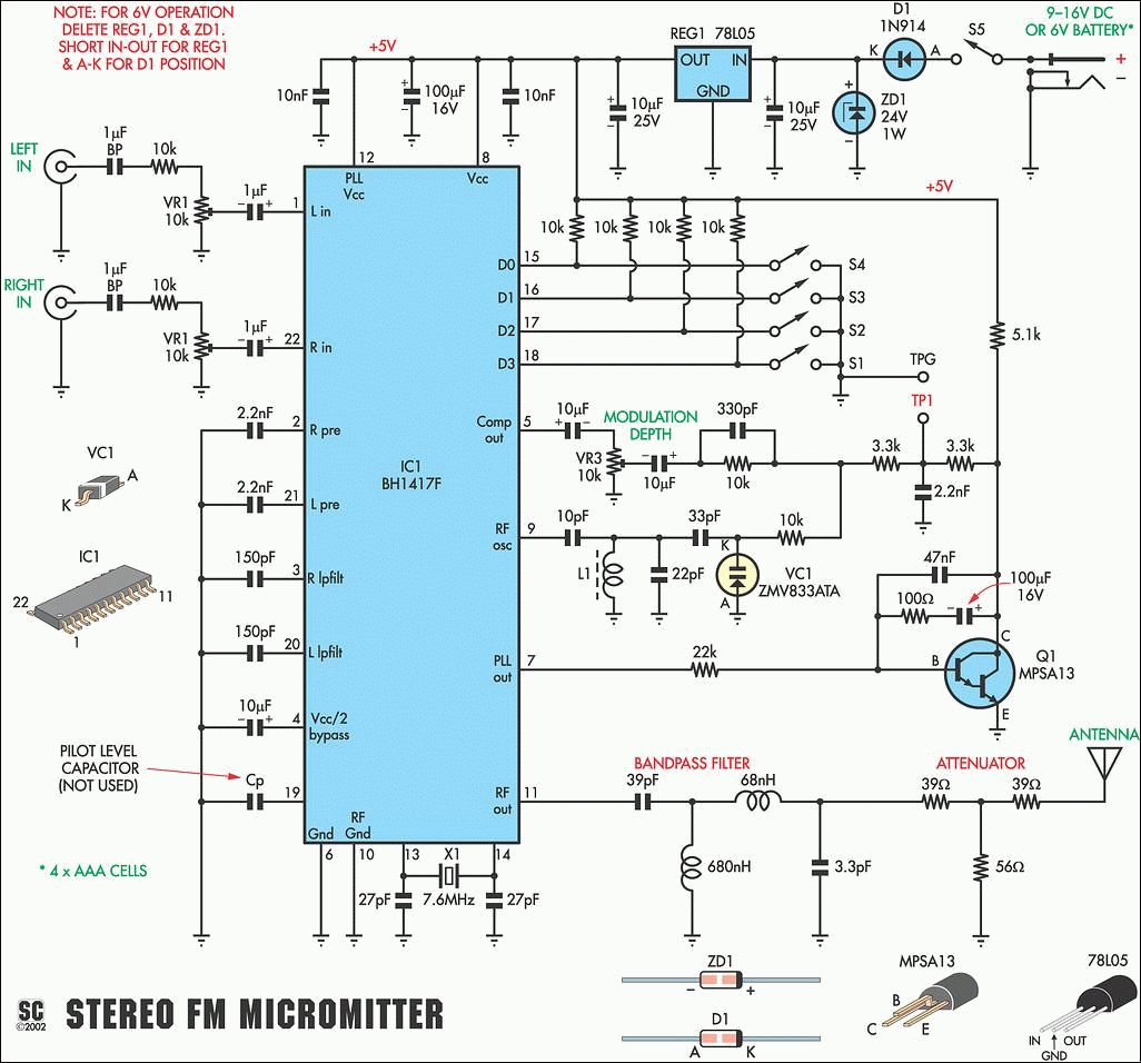

The BA1404 is/was a popular stereo FM transmitter, I think it has been superceded.

Rohm company discontinued their BA1404 simple stereo FM transmitter IC after receiving many complaints about its poor performance. They replaced it with a few much better ICs and the problems are gone. The Micromitter in Silicon Chip magazine uses Rohm's BH1417 IC. Its package is surface-mount only and the circuit is fairly complicated.
https://electronics-diy.com/schematics/BH1417_fm_transmitter.htm
