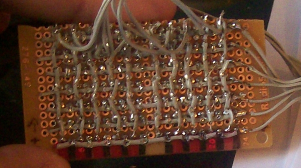

EDIT: Forgot to show the back of the digits. Its like a PIE lol
digitback-jpg.23294

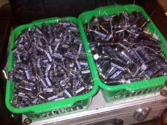

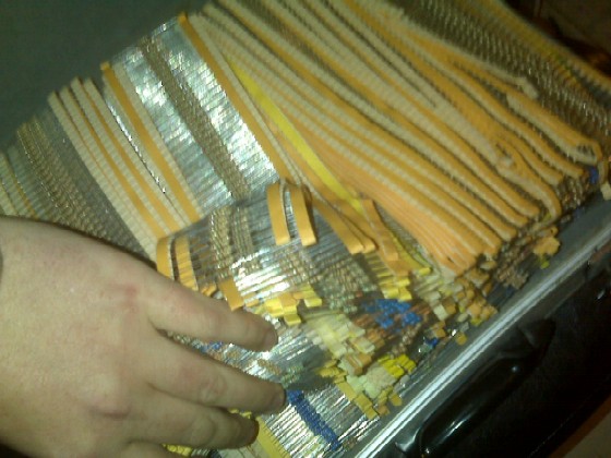

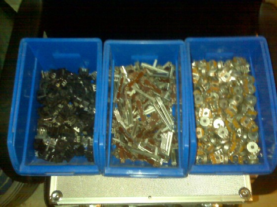

I would sell you bits real cheap - i have boxes of 7805s, tactile switches in many configurations, linear and rotary pots, capacitors coming out my ears and about 1000000 resistors - but I think the postage would be a killer.
Im working on a small kit of parts to make something simple but useful - that I can sell on ebay to people just getting interested in electronics.
UK .... hmmmm.... how much you think to ship to USA?

Wow .. (just seen the pics) Thats alot of stuff. How much to ship to USA? Well not all of it lol but a normal cost would be ?

I will ask at the post office next time im in how much it is to ship 500g to the US, then if your interested i'll give you a breif list of bits I have too many of, and you can let me know if your interested.
photos were just a small selection
