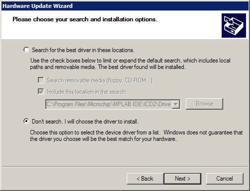

:( I'm sorry to be being so annoying here, but I can't get anything to work.
How do I force Windows to use the driver? I tried googling, but I couldn't find anything relevent.
I install a driver off my mini CD (don't think it was the right one) and got the cable to show up as HugePine USB-UART controller and it was "COM4"
Can it be COM4 or does it need to be COM1?
When following your HelloWorld poster, should I use the PIC16F877 in step 1?
I really don't want to give up on this. I'm determined to see that little LED blink.
From Device manager (my computer/properties/device manager)
You can force a driver.
It could also be a non standard USB Serial adapter. No IRQs are an odd feature. This site recommends other units for more compatibility.
Here's one that should work, it uses the Prolific (PL2303) chipset.
I use one from Tiger Direct. Also do you have access to a desktop computer with a rs232 port, these will work. And you must change it to COM1 or COM2 (they have IRQs)

Thanks again Bill for your continued help.
I tried forcing the driver and changing it to COM1 and it still won't connect. Either I am really lost, or the cable isn't going to work for me.
I am using a desktop computer, and it does have a serial port. Is this a better way to connect? I just got the USB for the ease of being able to plug into my front USB ports and not have to crawl behind my desk.;)
