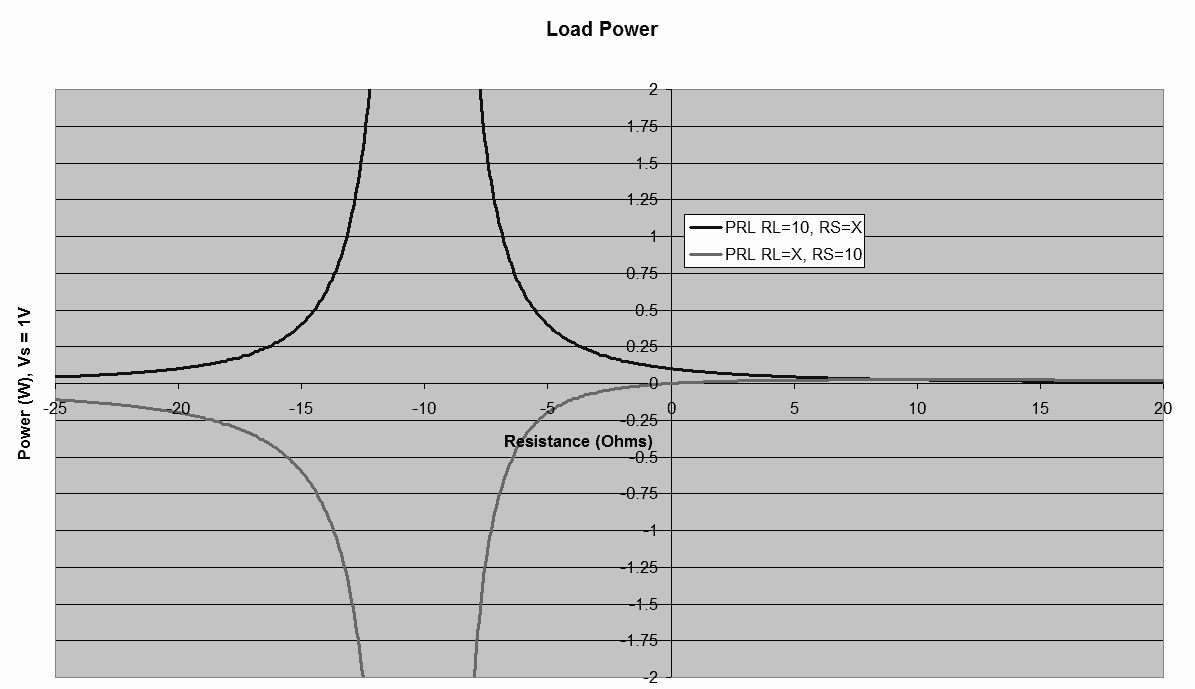

Wow, this is still going.
SimonBramble's proof relied on RS^2 = RL^2. That doesn't mean RS=RL; RS=-RL is also a solution. A negative resistance is not valid, so for all realisable resistances, i.e. R >= ~0, the derivative=0 method won't give us all the answers we want, as it doesn't take into account that resistance may not be negative.
Here's the graphs for the power through a fixed load; one includes a negative resistance range just for viewing pleasure, the other only positive resistances.
For a fixed source resistance, RS, you can see maximum power is at RS=RL=10 ohms.
For a fixed load resistance, you can clearly see it's maximum at RS=0 ohms.
You are incorrect. The existance of a solution for negative resistance does not disqualify the result RS=RL as a solution to the maxumum power transfer equation. This can easily be proved by induction. Assuming RL=0 would result in P=0. Likewise, RL=∞ also resluts in P=0. Thus, RS=RL is a maximum by the maximum value theroem.
That's irrelevant, since we are not talking about RL being fixed. We're discussing maximum power transfer, which always occurs when RL=RS.
I never said that. Try reading.
It's relevant to the point made by Rachit. There seems to be a bunch of blind followers around; what Rachit was saying (at least in the first post, I haven't really been paying much attention) has been true.
