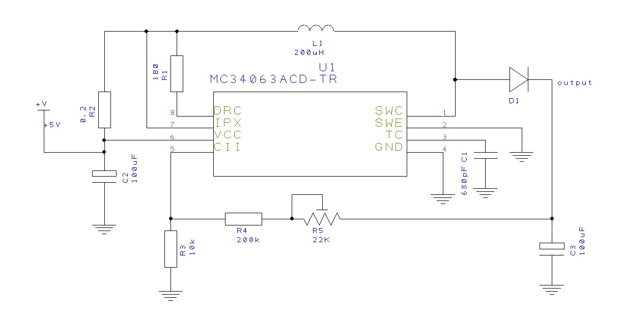

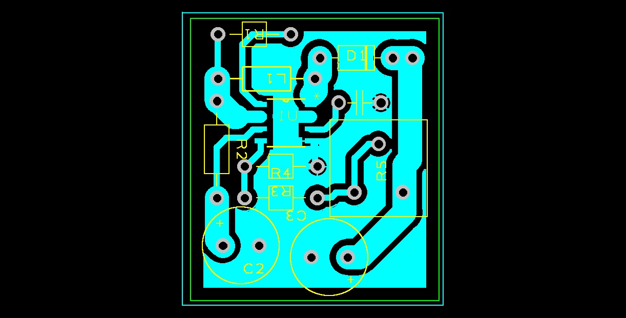

Ok here is schematic and PCB. It's the same as the example boost converter given in the data sheet. Values are a little bogus, not sure exactly what I used. I wanted to be able to adjust the output, hence preset inserted.
Tested it with the 'scope today. Changed the cap from a 330pF ceramic to 680pF polystyrene, however it made no difference. I discovered that as I adjust the preset, it goes from discontinuous mode at lower output voltages, to continuous mode at higher output voltages. The point at which it changes from discontinuous to continuous mode is the same point above which the output will droop when a load is applied. Used a heavier load - 150 ohm, output dropped even further.

I'll take a look at that. In the mean time, what is the duty cycle when your load is 1k ?
One thing you can also check is what the max current through the inductor should be given your switching frequency.
Another thing to think about is that in a boost converter if the duty cycle goes above a certain limit, the output voltage actually decreases. So a quick test would be to start the circuit with no load, then apply a 1k load while it is still running. See if the output stays higher or goes lower again.
Typical boost converters are a little strange compared to other topologies. With the circuit operating normally when a load is applied the output voltage drops down a little and this in turn tells the control circuit to increase the duty cycle. The duty cycle then increases, and the output rises back up again to the right value. Once at the right value the duty cycle stays more or less constant.
If the load is again increased however, the same thing happens, but at some point when the load is increased the control circuit again increases the duty cycle but instead the output voltage DROPS FARTHER DOWN, and this in turn tells the control circuit to increase the duty cycle even more, and that makes the output voltage drop again. This continues and it may NEVER snap back into normal operation even if we remove some of the load. The feedback mechanism changes from the normal negative feedback to positive feedback, so the output stays low.
This occurs if the duty cycle exceeds that magic limit due to the resistances in the circuit.
A problem that could result from this maybe is that during turn on, the output voltage is low so maybe the control circuit increases the duty cycle more and more as the voltage rises, but before it gets to the normal operating point it passes that magic duty cycle limit and so it never gets up to normal operating voltage.
In this case we would have to add a slow start mechanism somehow, which only allows the duty cycle to change so fast during start up so that the output gets a chance to respond before the control circuit takes it past the point of no return.

Ok just had another tinker. I tried a couple of other rectifiers, first a big fat high speed rectifier, which improved matters, then I found a shottky on an old board, so put that in amd things improved much more. I also tried a few different inductors. With a 12v input (well, actually just over 10v, it's supposed to 12v), I can get 26v out into 100R load, so I'm happy with that. With a 5v input, I get 15v out with the same load. Looking at the duty cycle I'm getting a lot of overshoot and ringing, which I suppose is causing inefficiency. M/S ratio seems to go no higher than 5:1, which I think is a duty cycle of 83%, close to the limit allowed.
So I think I'm going to get a beefy shottky I saw on eBay, fit an external transistor, and wind a tapped inductor, and see how that goes.
I'm wondering about parallel rectifiers. I would need to put in current balancing resistors, but I wonder if these would slow things down noticeably due to junction capacitance? And if it does, if I put a small fast signal diode in reverse parallel with each resistor, would it overcome the effect?
I think you are suffering from the old tolerance build up problem. :banghead: The biggest is probably the on to off ratio. The range extender in the page you posted would really help that. Then you loose some across the sense resistor, the inductor, the Darlington and finally the diode.
Yes, I finally discovered that the losses you mention make a big difference at low input voltages. I just hadn't realised how much. Given the PSU I'm using is also a little low, it's no wonder I'm having problems.
