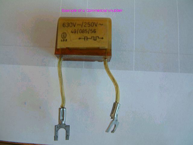

Hi, i want to design relay circuit to switch ac motor without causing noise to the MCU. I put diode on the relay coil but what about the contactor on ac side?
A RC snubber is typically used or a MOV, I prefer the former, you can buy them as one unit.
Max.
I have used them many times and it has cured intermittent noise problems.

The problem is the mcu and connected lcd are disturbed when i connect the ac power so i think the problem is with contacts. In general i want to protect mcu from coil and contact
Is this enough for relay switching noise?
How to calculate its value?
The value isn't too critical unless you're optimizing. If you have an oscilloscope you can use trial and error until the switching overshoot/undershoot is criticall damped. If R is too big and C is too small, then there will be little effect. If R is too small and C is too large then the RC snubber might heat up too much and you'll have a little bit less efficiency.
0.1uF is pretty big for a snubber capacitor so you could just try that and try a bunch of different resistors from 1ohm to 5ohm until you find one where the components don't heat up too much. If the cap heats up then use a higher resistance. If the resistor heats up too much, use a higher wattage resistor (or you could also increase the resistance as well but this reduces the snubbing).
The main goal of an RC snubber is to slow down the rise time of the spike rather than to actually clamp or suppress the spike (although it does that too to a limited extent).
