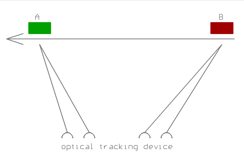

Here's a sketch using optical sensors for two objects moving on the same plane.
Example: Object A moves at a speed of 3m/sec, object B moves at 3.5m/sec. So the relative speed of object B is 0.5m/sec higher than that of object A.
By the angular difference of one sensor pair the distance between sensors and object can be calculated.
The speed can be measured by the known distance to the object course and the angular change of the tracking device over time.
Using the relative speed of the "overtaking" object the collision point can be exactly predicted (provided the speed remains constant). Otherwise calculations have to be updated in short invervals.
May be that helps defining your problem clearer.
Boncuk

I see your point now. Sounds like a good suggestion. The tracking-part seems to still be the challenge, and I assume that should be some sort of vision based algorithm.

No, it's just spheric arithmetics. :)
The rest has been done already by optical tracking systems being used for terrain observation and surveillance.
I forgot the name of the company. It is located in Austria and offers a burglar tracking solution. The target is being tracked by several optical systems (depending on terrain and building layout) overlapping in radius and never looses contact with it.
Their slogan: "If the burglar doesn't know where he is the system can tell him."
May be I'll find the company's name after opening some drawers in my brains.
