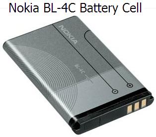

The battery is a Lithium-Ion type. The 3rd contact is its temperature sensor.
The only time I have seen or read about repeat problems with lithium batteries in consumer electronics is, from defective batteries (real namebrand ones) or, and these are the most common, bogus, bootleg namebrand or just cheap crap from China.
what do you mean by the 3rd contact? is it on the center?, on our charger circuit, will be going to use the 1st and 3rd contacts (indicated with + and -)
The temperature sensor is the middle contact but I don't have any spec's on it.
