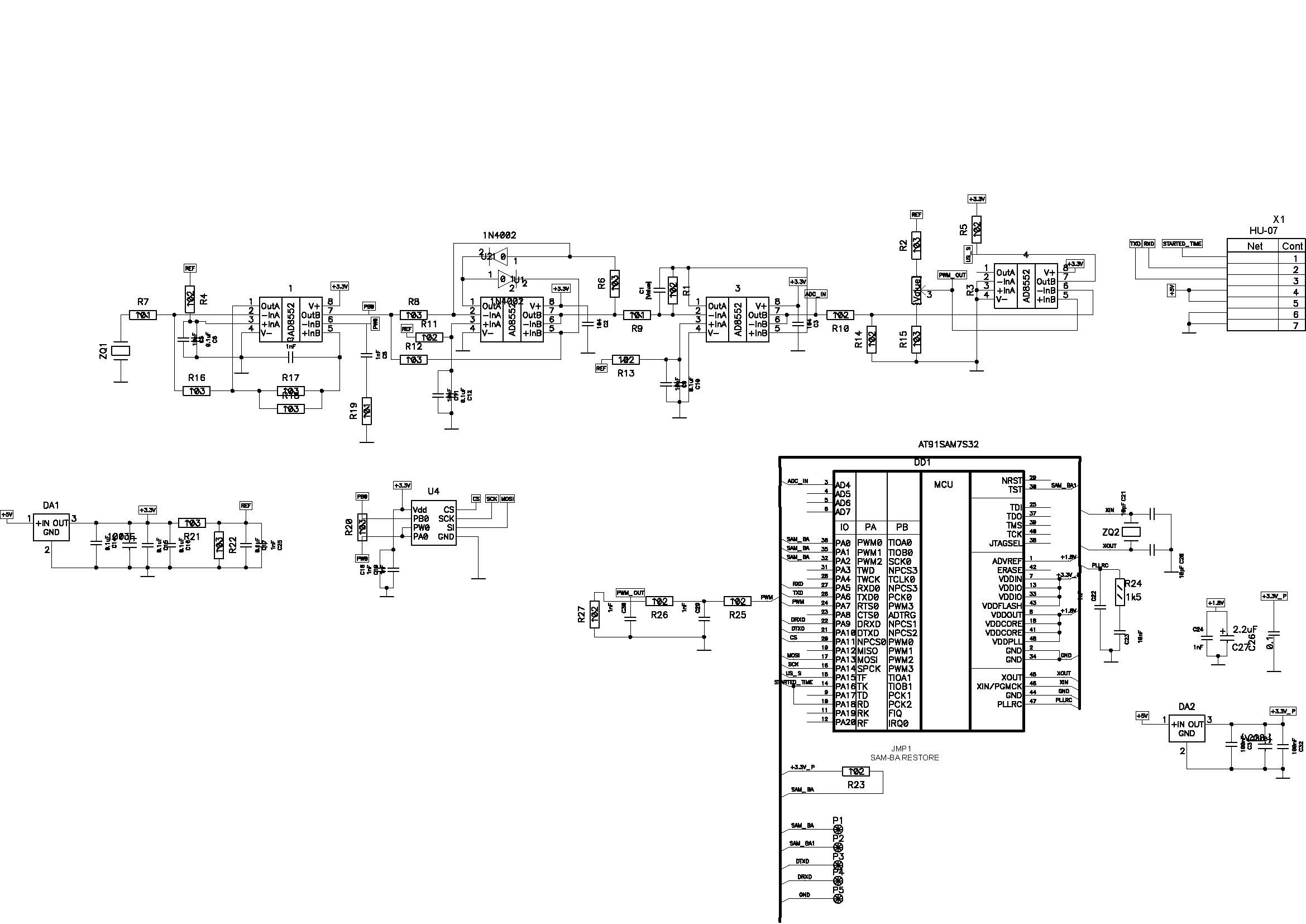

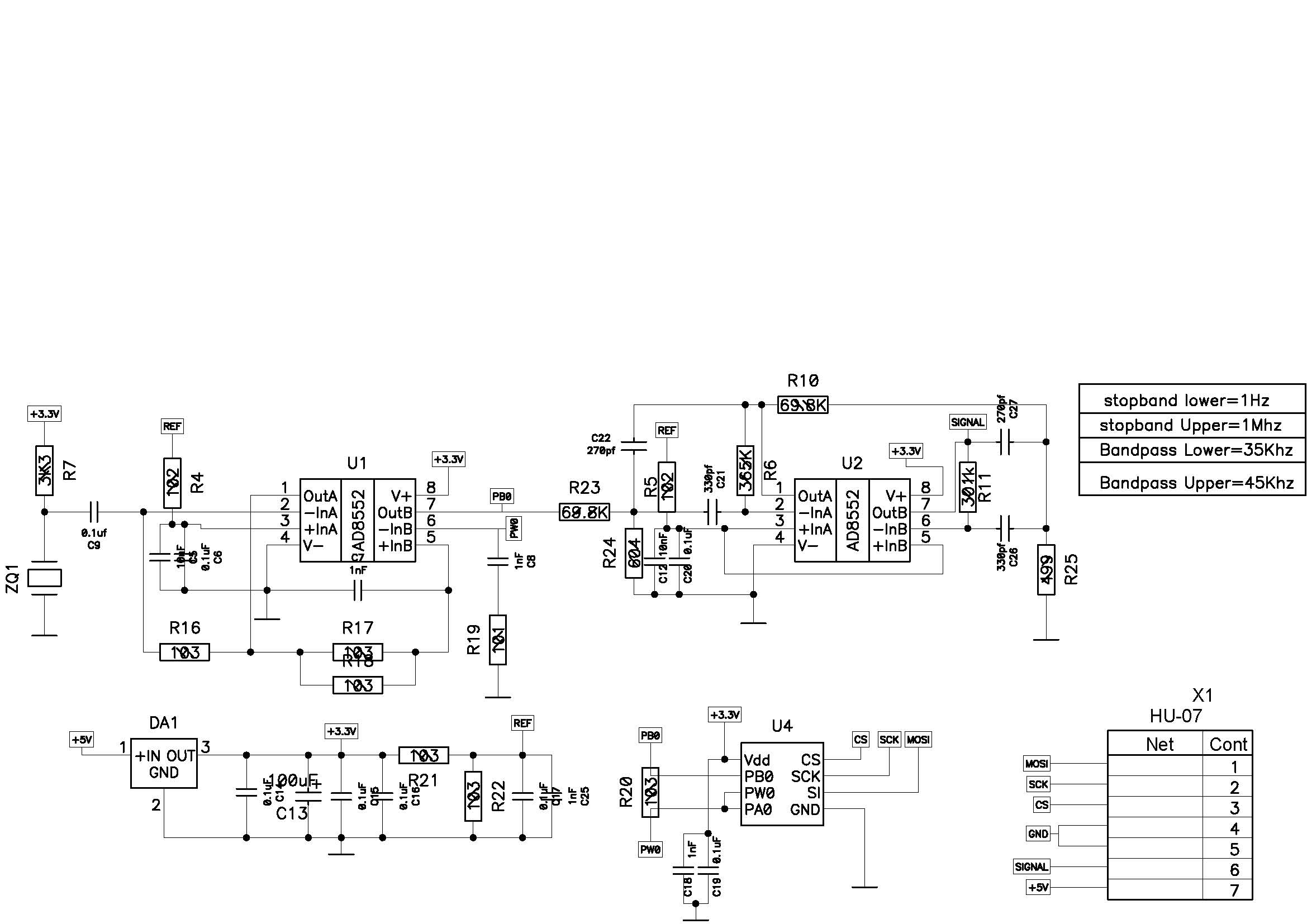

I have a problem with getting exactly time of flying with high resolution! I'm using dspic for getting peak of ultrasonic signal! peak of ultrasonic signal is jumping one period ! How can i solve my problem :confused:!
At the moment i have two version! first one i used ultrasonic reciver and second one i used elctronic micrphone with bandpass filter!
Second version gives me very high resolution but my filter not helping me from other signals
:confused::confused:

in my first version i used ultrasonic receiver and amplified with 5000 times and after that i rectified it and then i used filter. that my version gived me one period error it means 4.28 mm error .
in my second version, i used electronic microphone as a ultrosonic receiver. received signal amplified 5000 times and that signal is converted to digital signal with dspic(500 ksample/s). that version was gived me 0.686 mm error, but it has many feedback, for example microphones band!

How do you plan to get 0.5mm accuracy? What ultrasonic frequency are you using? If it's, say, 50kHz and we take the velocity of sound as ~ 300mm per mS then one wave period corresponds to 6mm. If you only detect the wave peak then the distance resolution by my reckoning will be 6mm (or 3mm if you use reflected ultrasound).

i think everyone knows about Mimio Xi interecative whiteboard, in that documentation wrote 0.3 mm resolution! i opened and learned . there is a dspic 40mips processor and 500 ksample/s ADC. i want to build my version(for interest). my tranmitter work on 40Khz, if i got half perriod error duriing in receiving ( 1/80000*343m/s=0.0042875m=4.28mm). At the moment i'm not understand recived and transmit signal! there are not similar! i send only one period of signal from tranmitter but in receiver i got many period(Using ultrosonic reciver). but if i used electronic microphone, tranmitted and received signals are very close to each other.
The multiple periods are due to ringing of the receiver in response to pulse excitation. Ringing is undamped (or lightly damped) natural oscillation.
