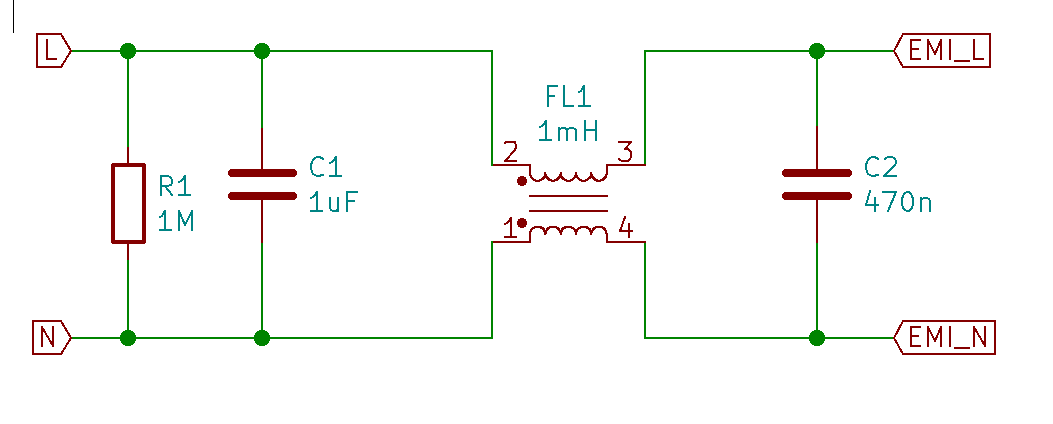

Does anyone has schematic of passive emi filter for 100khz smps or better method of calculatioj? I cant find any procedure to calculate that.
i used this values

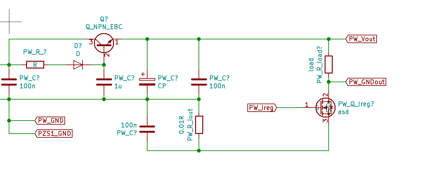

Actually working on current feedback loop. If current sense resistor is 10mOhms then with 0,1A there is 1mV across it.
QUESTION is:
What should be lowest output current? after 0A... =)
0,1A is easy to do.
I think 10mA is lowest i am capable design.
At lower currents im aware of noise.
Max is 5A.
You should be able to easily add an op amp with a capacitor across the feedback resistor to amplify the voltage drop across the sense resistor and filter the noise. If your sense resistor is connected to ground (not supply) you should be able to get a pretty stable voltage without much noise across a low value resistor.
You should be able to easily.
Do you think that sensing 10uV for achieving 1mA resolution is easy? I should use two 10x gain amplifier than i guess. low drift / low offset
My idea for current adjust is to sense current, when is above some value then stop pwm. But with big "B" if cap is charged and load is connected it will lead to current peak and then its should stabilise current. This will also lead to automatic voltage regulation for load.
To prevent current peaks i will need transistor probably mosfet in series with mosfet (with BJT it will work as emitor follower and i have only 12V supply for logic).
I wonder where to measure output voltage and how much i should care about precision.
If i measure it across output pins of pwoer supply its still wont be correct voltage on load due contact resistance and resistance of wires.
If i measure it at PW_vout to GND i will get like 0,1V drop on 5A due mosfet RDS and shunt resistance.
PW_VOUT to PW_GNDout requires diferential amplifier etc but provides better voltage reading.
PW_Vout to PW_GND is easier and cheaper.
BTW display resolution will be 50.00V and 5.000A so 10mV step and 1mA step.
Also i sets voltage on load with multimeter. Its the best way
measured voltage is for feedback loop + readings on psu
Is this usable https://www.ti.com/lit/ds/symlink/ths4561.pdf for feedback loop
