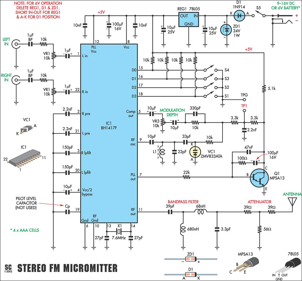

About 7 years ago, Silicon Chip magazine in Australia published The Micromitter FM stereo transmitter project that uses the BH1417 IC:
